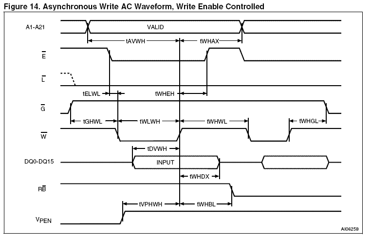

https://www.st.com/stonline/books/pdf/docs/9083.pdf
as you can see to write to this chip is , not impossible but difficult at best..
to do a write with the serial port would take intimate knowledge of serial port communications.
also it would require a fairly elaborate circuit , consisting of serial to parrallel shift register, a 3 to 8 line decoder , flip flops to store the signal levels..
hope this helps..
