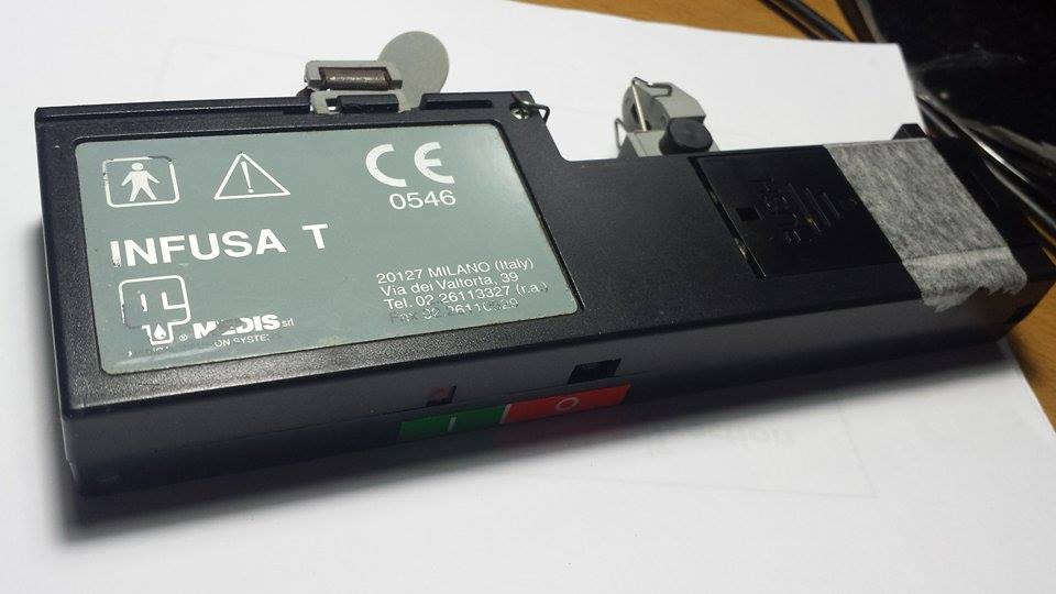

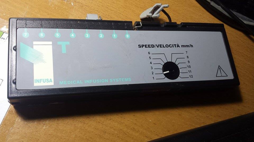

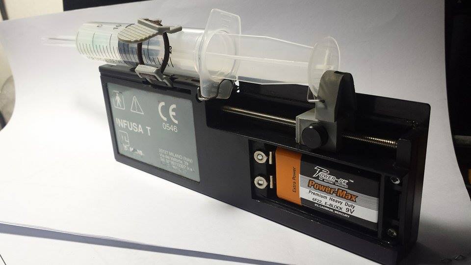

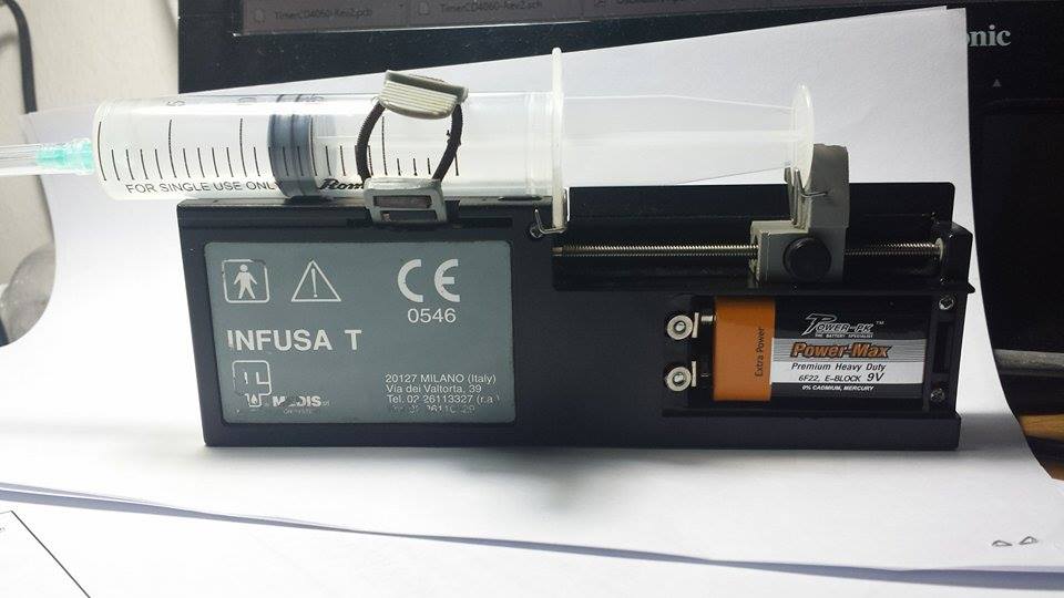

programming motor to operate to work in milli meter/ hour.
12182205_10153522796711195_1993035977_n (1).jpg 12200412_10153522796626195_2076873485_n.jpg 12200441_10153522796666195_1179845893_n.jpg 12200631_10153522796536195_1240348690_n.jpg 12200800_10153522796766195_1975754290_n.jpg
Here is the existing syringe driver pics. hope you guys get some idea how it works.
will upload the inside pics later.
First you need to measure the pitch of the screw in order to calculate rev's or fractions of/min.

What I thought. You need to measure displacement per time and time. RPM is very influenced by load. Shaft displacement can be measured by the sensors.
I don;t think it's as simple as turning the motor on/off for a certain time, if you want accuracy.
Having seen worm gear syringe drive and stepper motor drive pump on a fixed hose diameter , the trend today is towards pulsed DC motor driven pumps apply pressure to an elastic hose with a cam driven impeller.
This can be very precise if properly characterized as a "Transfer Function" from current to torque to acceleration to velocity to rotation to linear hose flow to volumetric flow.
It is like worm gear current * time to torque to acceleration to rotation to linear displacement to syringe incremental volume displacement is a "transfer function"
