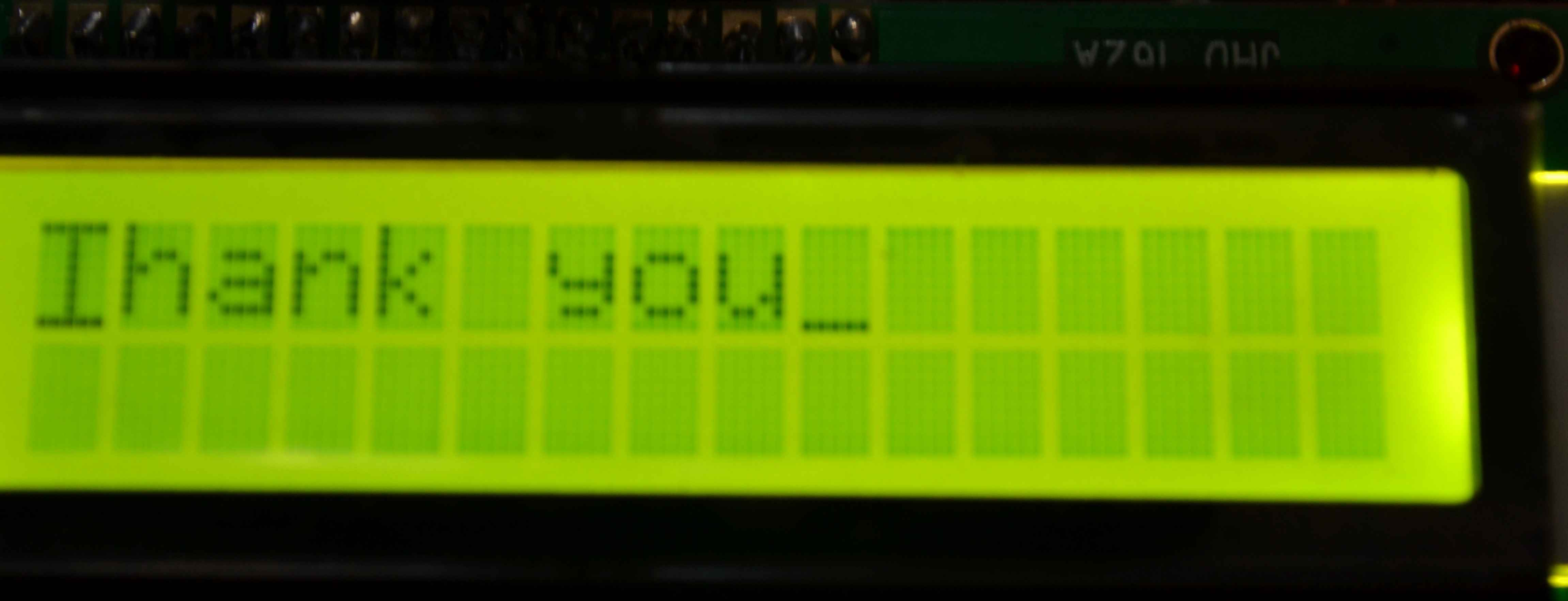

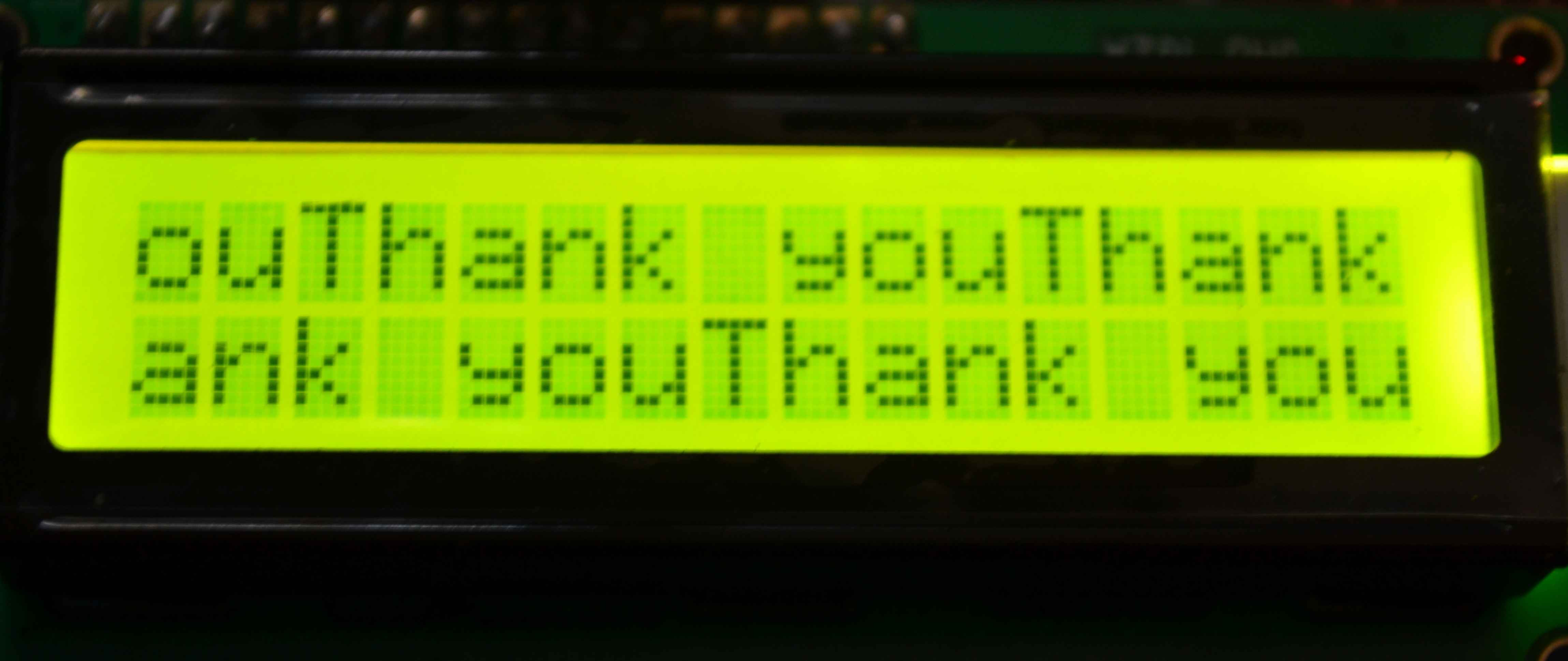

"You should take initializations out from the while loop and call them only once at the beginning of the program"- Sir before it worked normally but after i removed initialization out of loop i am getting weird results on LCD display. I have attached the pictures of before and after display of LCD.
Picture-1 represents the LCD initialization done outside the loop and Picture-2 represents the LCD initialization done inside the loop.
Between i use AVR GCC sir.
When you write to the LCD the cursor stays at the end of last string you wrote.. in this case at the end of "Than you". Next time you write to the LCD the text is written starting from the place where you left the cursor.. in this case "Thank youThank you". You need to clear the LCD before each write. Clearing the LCD also moves the cursor at the beginning. Initializing the LCD clears it and moves the cursor at the beginnin, but also does some other stuff which are unnecessary.

The LCD_clear() function can be named differently.. check your LCD library for correct function.
Thank you so much sir. :)
I got the output correctly.
