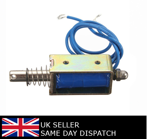

Would this door striker be compatable with pulse time and duration? Thank you

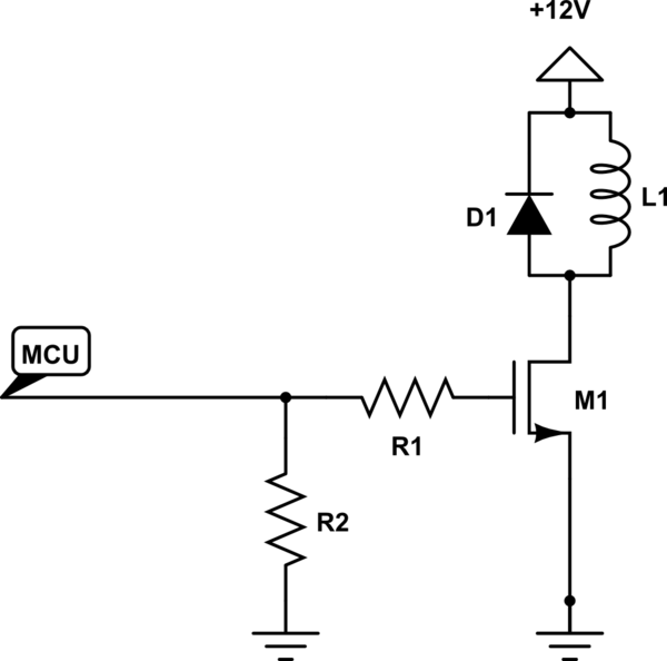

Yes, you experiment with pulse width to get the effect you need. If you are programming.
Keep in mind you drive it as follows from micro :
Regards, Dana.

Sorry for the late reply. It took me a little while to order parts. First Solenoid ordered was too small with 10mm of travel. The brass tip of the 10mm solenoid sounded bad against the metal bowl, putting rubber on the end did not help. So I went with a 30mm travel larger solenoid to actuate the mallet.
Here is where Im at!
Picture Full Size: https://ibb.co/HCz0bcH
Part: Solenoid 35mm Push Pull 12V
I can manually make it go GONG when I momentarily connect the terminals to my power 12V 8A power supply. Work and sounds great!
