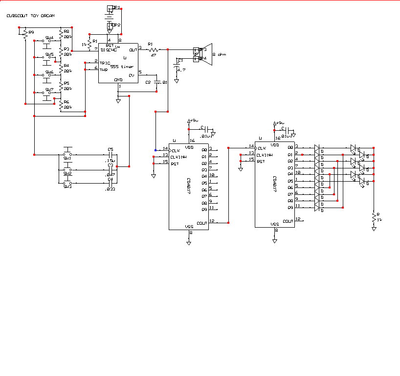

really amuzing project
I built the 555 section for my cub scout pack and they really enjoy it.
going to add the "Knight Rider" section later.
very simple circuit and has lots of splash.
If you wanted to add more switches for more tones, even a rotary selector on the outputs of the first 4017 thus dividing by X
as pictured it divides by 10
lots of additional ideas can be added.
Even have PCBoard file if you want (express pcb)

Thanks for the suggestion MrDEB, however even that circuit might be at my limit of understanding, so I'm not sure if I can make it.
