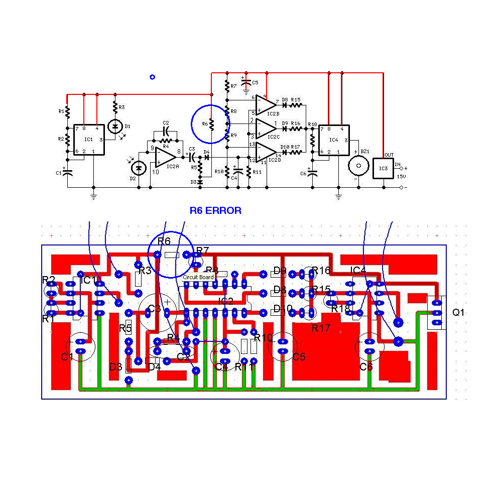

I've come up with this pcb layout, but I'm not sure if it's 100% accurate. Can you please give me a hand and verify it?
There's another resistor soldered directly on pins 2 and 13 of the LM324, but it doesn't show on the layout.
So what exactly is your question? Do you want someone to check your layout for you? Not gonna be me. Print out your schematic, and your layout, take a yellow highlighter pen and start checking each trace on the layout and compare to your schematic. Highlight each trace you verify to match your schema. That is how it is checked.

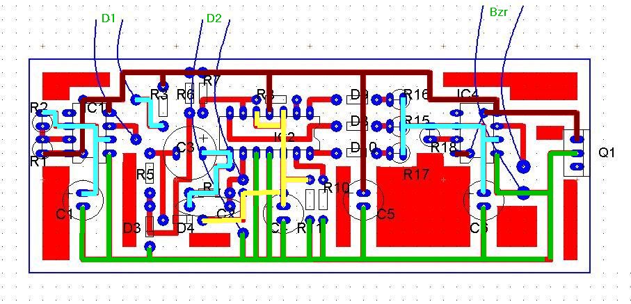

hi DWBH,
There is a difference twixt the cct and layout, see this image.
Part done with Paint Shop

hi DWBH,

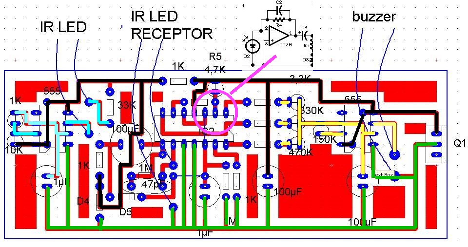

That section (signal amplification) is done with pins 8, 9 and 10. I thought it'd make the layout more tidy.
So, for the IR signal amplification I used opamp C (8,9,10) (instead of opamp A). For the voltage comparators I used opamp B, A and D, instead of the opamps B, C and D respectively.
I should have updated the schematic, and put the parts numbers on the layout. Sorry.
Do you want it rechecking, if Yes, then post the updated circuit. [Just the cct diagram]

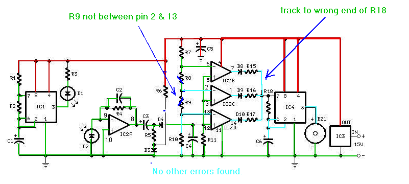

Here are the updated schematic and diagram.
Don't mind about part values.
Also, important to say that R9 is NOT on the parts diagram, as it is going to be soldered directly on pins 2 and 13.

Not quite there yet.!:(

I think it's all set now:
Ok, Ill give a check thru, will post later today.
You understand why I am not making any corrections for you to the layout.:)
Just 2 errors, marked on the layout.

Yes, R9 is not represented, as it is going to be soldered directly on pins 2/13. :D
