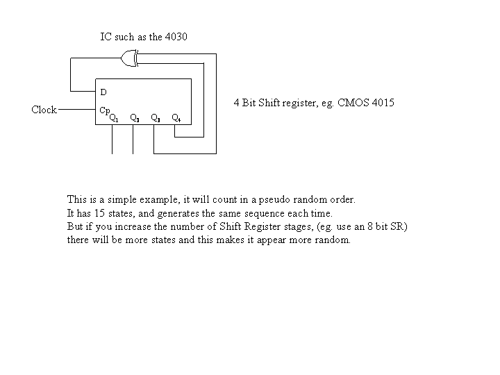

How about using a circuit for "chasing led's", lets say 8 of them. If this was running continuously, and somehow (havent figured this part out yet), lets say replaced the led's with 8 different resistors. If a momentary switch was closed and directed through the circuit and the corresponding resistor value, they would be random enough for my purpose.
Does anyone think it could work? Im in the middle of another project but this one is next in line.
Im looking for random delay on times from 0 - 8 seconds using a 555 ic.
I'll keep you posted.
Thanks in advance.
A psuedo random sequence can be generated by a shift register with an XOR gate generating the feedback.
A 4 bit SR will give you 15 states (see attachement) and an 8 bit 254 states.
So a LED would be connected to each output of the SR.
