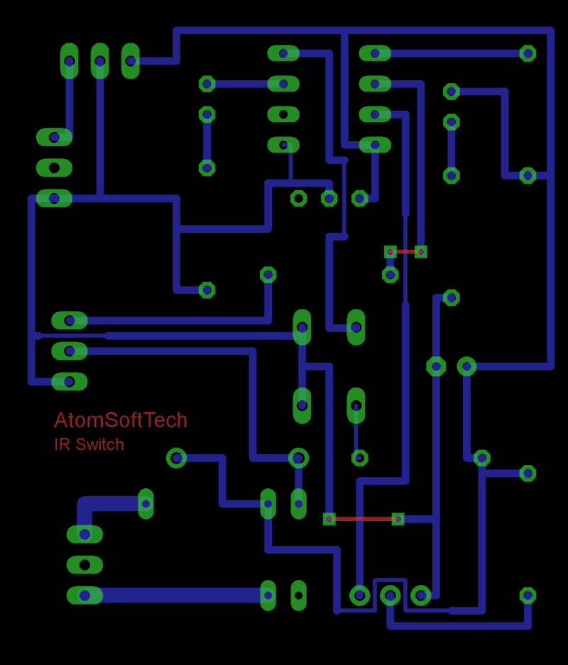

Also here is a PCB i will be making. Does it look clean? Neat?

Get rid of the 90 degree angles. Cut them all off at 45degree angles. 90degree angles are generally frowned upon in PCB making and they can have problem etching.
After a quick look. Your bottom right trace that goes between two pins could just go around everything and not go through component pins at all. Increase the drill size of your vias if you are making this board yourself.
EDIT: Your text is on the top layer. If you don't know already, learn how to do a ground plane fill. It helps save etchant.

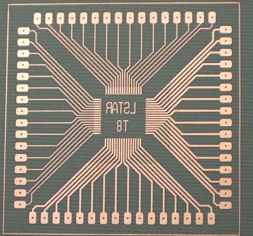

20090701-stellaris-pcb-001-jpg.31048

Have used toner transfers, but no experience of the Pulsar system; wondered if you have considered the uv pre-sensitised boards, not cheap but consistent results.
With the availability of cheap uv leds a diy exposure box is very easy.
Sample of the kind of work I've done with uv leds shown below.
And the other trace above that runs between the regulator pins can just run above them, you can run it pretty much straight upward... ;)

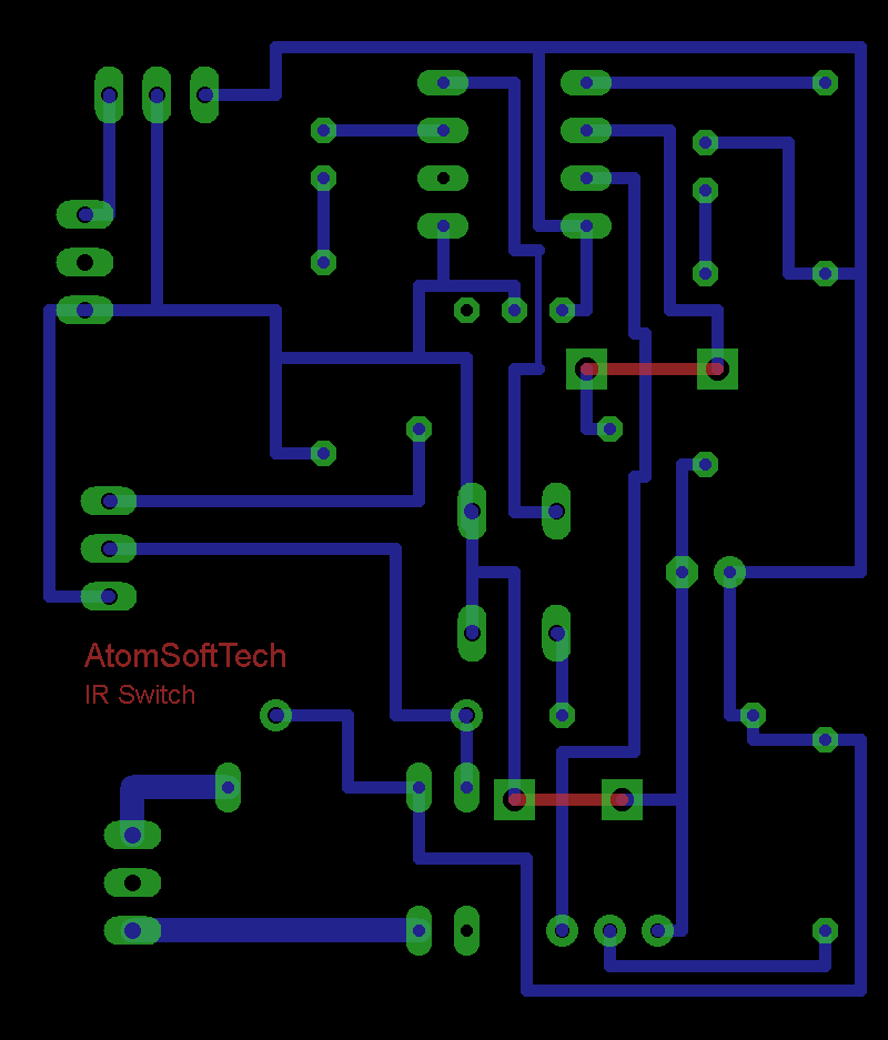

Hows this now? :

I was about to say the same thing but I normally get shot down when I say this so shoot me.:D
Try to make all angles greater than 90° and avoid T-junctions wherever possible - it makes etching more reliable.
That's much better.
G'day Jason,
That second design does look a heap better mate, now what I do with my designs where a T or junction come off a track I put a fillet in each corner so the junction is alot thicker. If you add that then hero999 might not wet his nappies as after some of his replies to other peoples boards really makes one wonder if indeed he did wet himself.

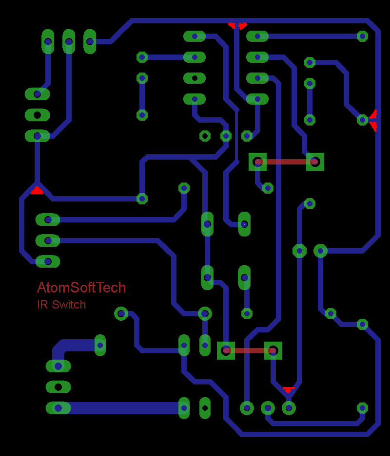

Hi Jason,
I marked in red what I meant
Cheers Bryan:rolleyes:
