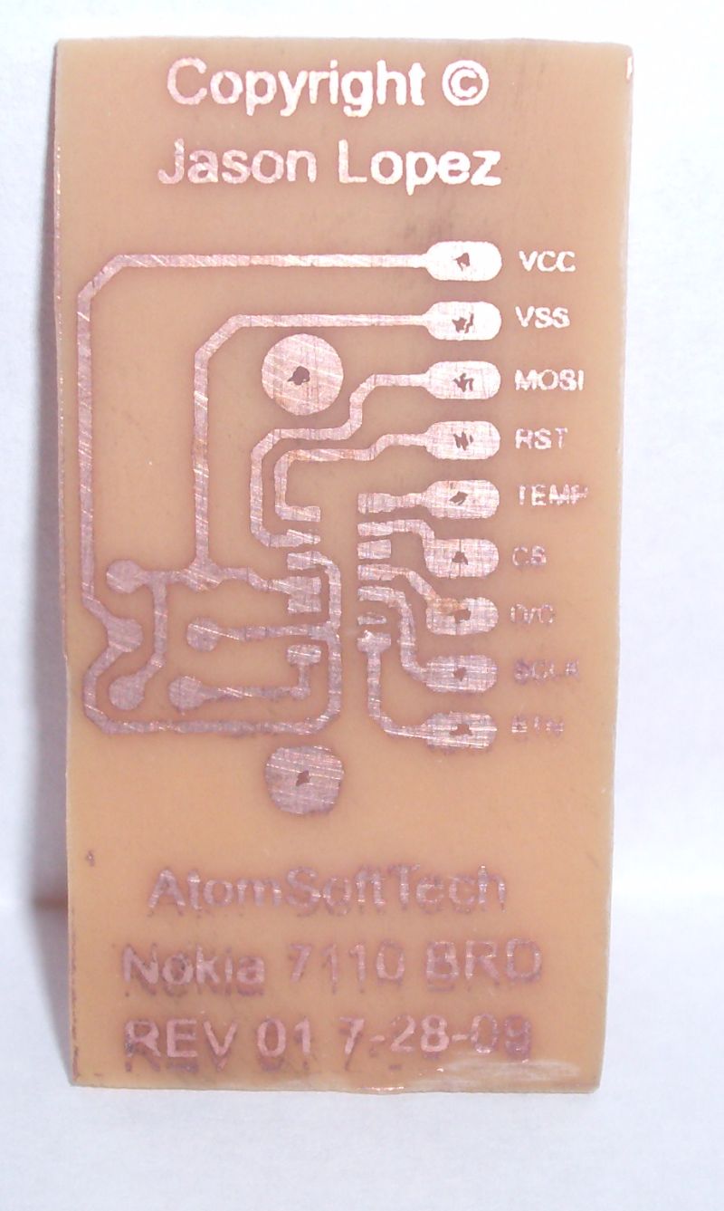

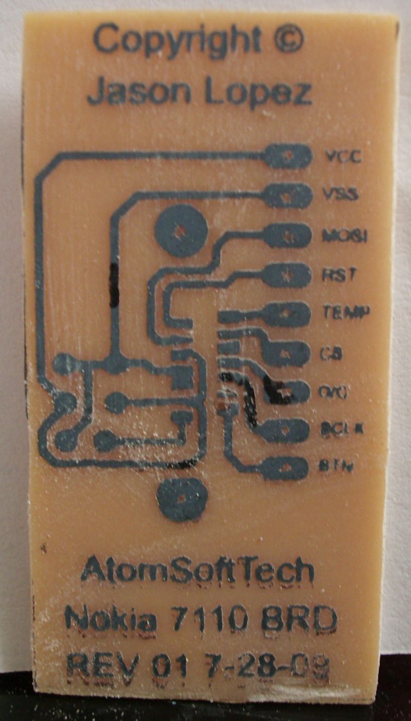

hey guys just tried out ROLFs paper and it works like a charm! I used a normal iron and got good results and paper came right off like magic :)
Here look. You will notice under the AtomSoftTech i smudged it a bit heh (i dont iron alot :D )
I think if i had a laminator this would have been perfect :D

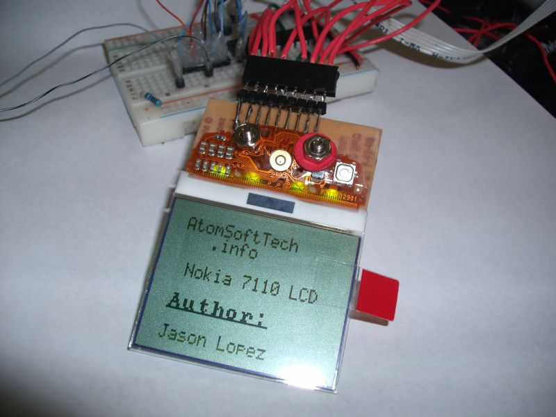

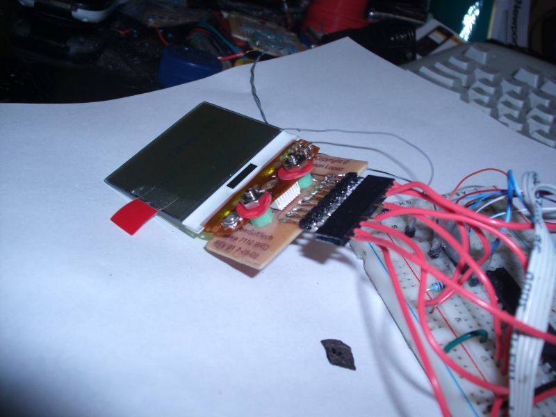

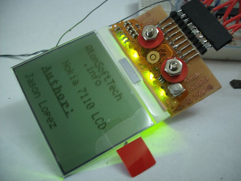

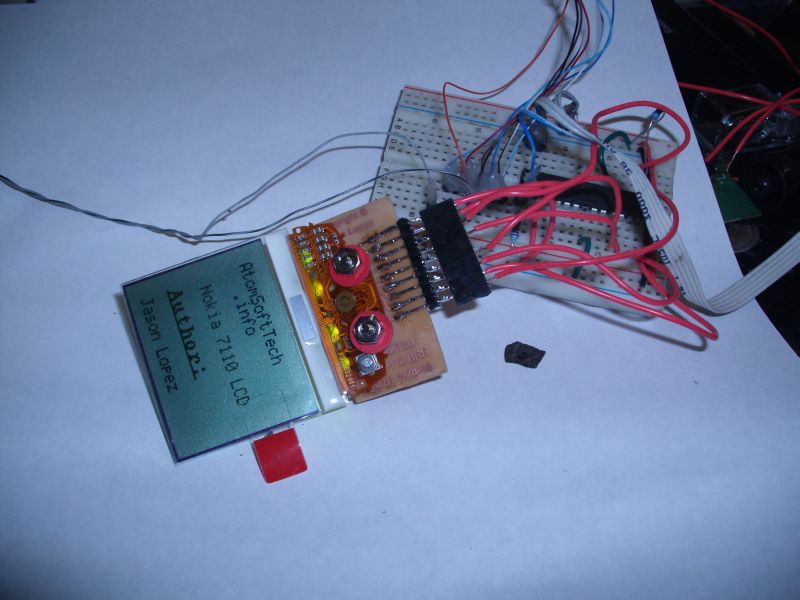

thanks and the coolest part is..... it works!!! :D

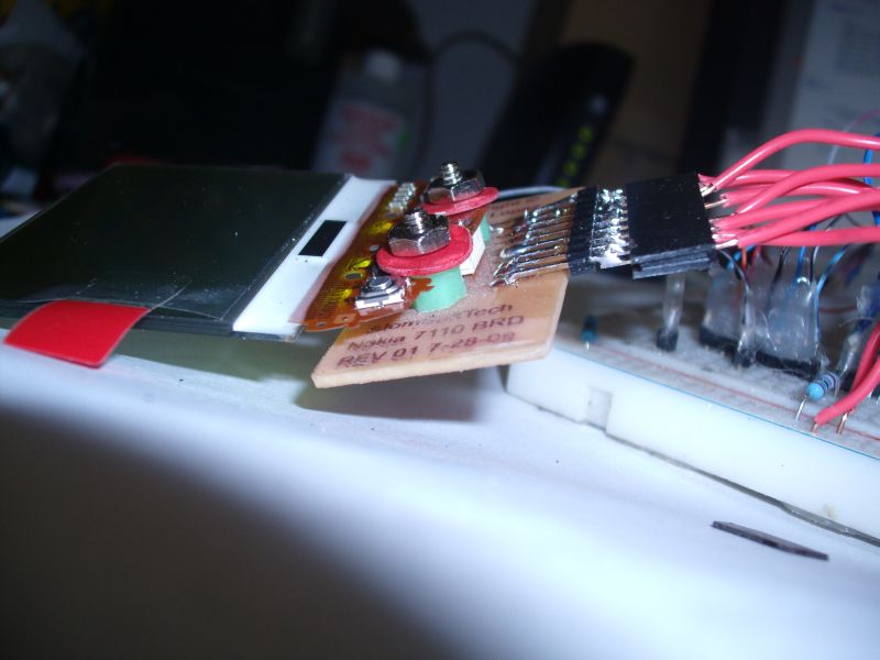

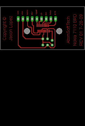

I'm trying to redo that connector. I'm thinking of cutting a hole in the PCB for that plastic connector to pass through and having pads right up to the edge, and the either soldering small wires to bridge the connectors and pads, or maybe bending the tiny connector wires over to the pads.
It's hard to explain, but I'd like to have something more solid.
i know exactly what you mean. Its like those game console mods. they have a flex ribbon that wraps around a SOLDER cups where you should solder this way its a perfect solder and right on targer
