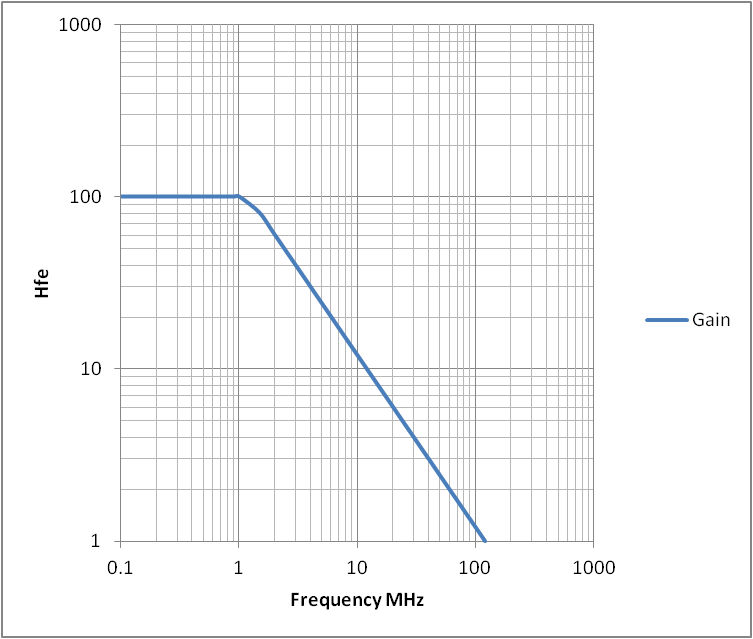

But in detail the transient frequency or current gain band product has "120MHz at 2V, 500mA"
Let us clarify...
The "gain-bandwidth product" is a number produced by multiplying the voltage gain of the transistor by the frequency at which you are measuring the gain,
The gain of the 2SC2328A is classified onto two groups Rank O and Rank Y, as per the little box at the bottom of the datasheet.
Say we have a transistor with a gain of 100.
That is the gain at low frequencies.
If we divide the 120MHz GBP by 100 we get 1.2MHz
So we have a gain of 100 up to 1.2MHz.
At higher frequencies the gain will drop off until at 120MHz the gain will be 1.
A quick and dirty graph of Gain vs Frequency will look like this:
It is quite common to use "audio" transistors like this at low RF frequencies.
Why they do not test the different parameters of transistor around audio frequency?
They test if for the frequency response it is capable of, not the frequency you may use it at.
That way you can properly design the circuit for your requirements, be it audio, video, RF, or other.
That's always the way such devices are specified.
