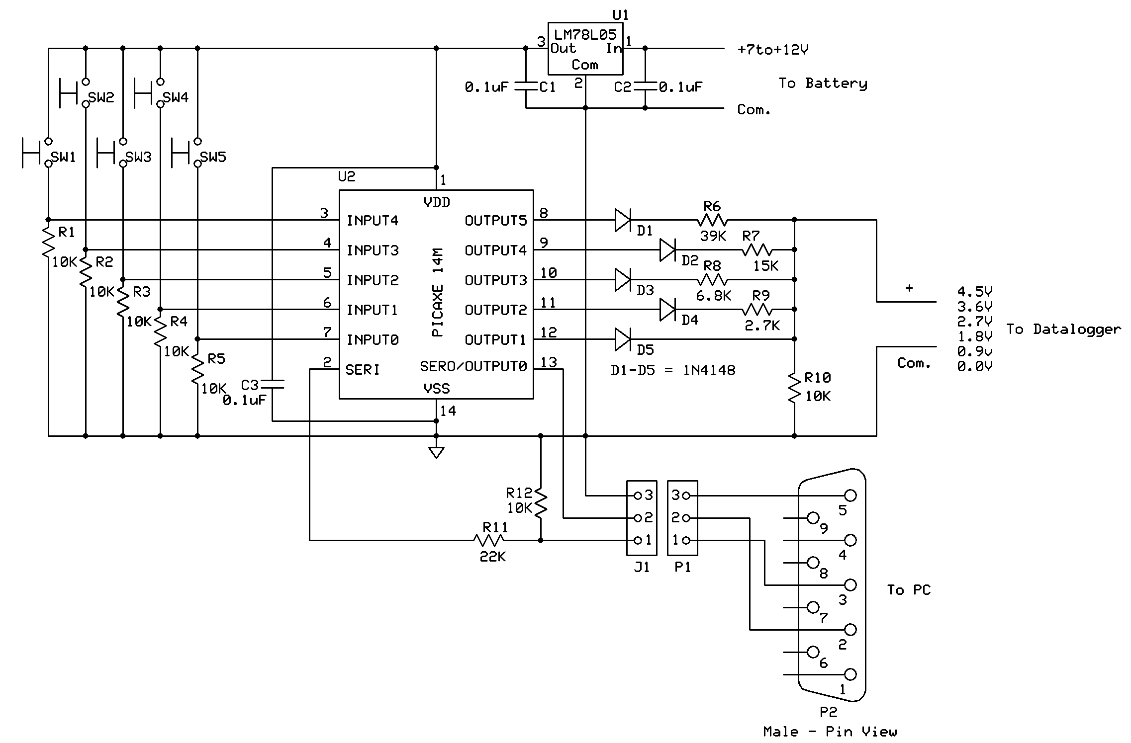

Like Mike said, read the button, store the value, output that value as a voltage level for >1 minute, and then zero.

The PICAXE 14M would do the job. 5 inputs, for your pushbuttons. 6 outputs. Use one output for a PWM digital-to-analog conversion, if you went that route. Or, use 5 outputs, if you want to go with an R-2R ladder digital-to-analog conversion (my preference...but that's just me ;) ).

Actually, forget the R-2R network. Just 6 resistors and 5 diodes for the D-A conversion....five OR'd voltage dividers.
ken
Here's the hardware. I don't have a Picaxe 14M to work out the programming.
Ken

Wow that was fast:) a few silly q's how do you upload pics ?? i am new to this site and we don't have help files.. The pic icon looks for a url so how did you create this drawing and upload it?? sorry I know it has nothing to do with my 5 buttons but I like to know. This circuit looks good if i want to use my original datalogger, but is lilimike idea good in that the overall size is smaller?? size matters;-} what I wil do tomorrow is outline the 3/4 sections/circuits of the overall project and seek your advice. I think its a fun project. its also important as it is a clinical trial.

I believe Ken's solution is simpler because the final output interface is provided by the EL-USB-3.

The schematic was drawn with ExpressPCB, a free program for schematic and printed circuit board development. The schematic was exported as a .BMP image in ExperssPCB, cropped and exported to a .GIF image in Microsoft Office Picture Manager. It was then uploaded by using the "Go Advance" > "Attachments" in the Reply.

I think the units can be as small as its battery + the PICAXE and a couple of SMT components. I have no experience with PICAXE and I just looked it up and it is a regular PIC with a bootstrap version. I would think you could drop the resistors at the input and use the pull-ups and drop the diodes/resistors at the outputs and use one port to upload the data on a serial port, this implies you have enough memory to store 720 bytes of information and I believe you can accomplish this with a PICAXE-28X2.

Remember that the simulation is running at an incredibly slow speed. Go to Options>Simulation>Simulation Delay and slide the bar to the left (20mSec delay). In real operation it will react immediately. You don't need to set the input high. You detect the button, set a corresponding output high, GOTO a 1+ minute delay, clear the outputs, and return to continue the scan.
Though...I like your use of a pin as an input and output. I'll have to think about the hardware side of that.

I just had a realization on the PICAXE 14M. The outputs are open-collector darlingtons, not totem-pole, source/sink. That means my circuit will not work as drawn. The programming will be much the same, but I will redo the output side as I have time. Darn vacations! ;)
Ken

Never mind my comment about the open-collector outputs...I read the data sheet wrong.
Barb wasn't feeling well this morning, so I'm letting her sleep. :(
I played with the programming and came up with this, for my circuit. :)
I was also thinking about selecting more than one button at a time. Since it's almost impossible to push two switches at "exactly" the same time and the scan is very fast, the first pushed will be locked in.
This should work.
