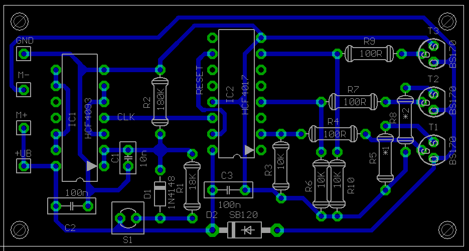

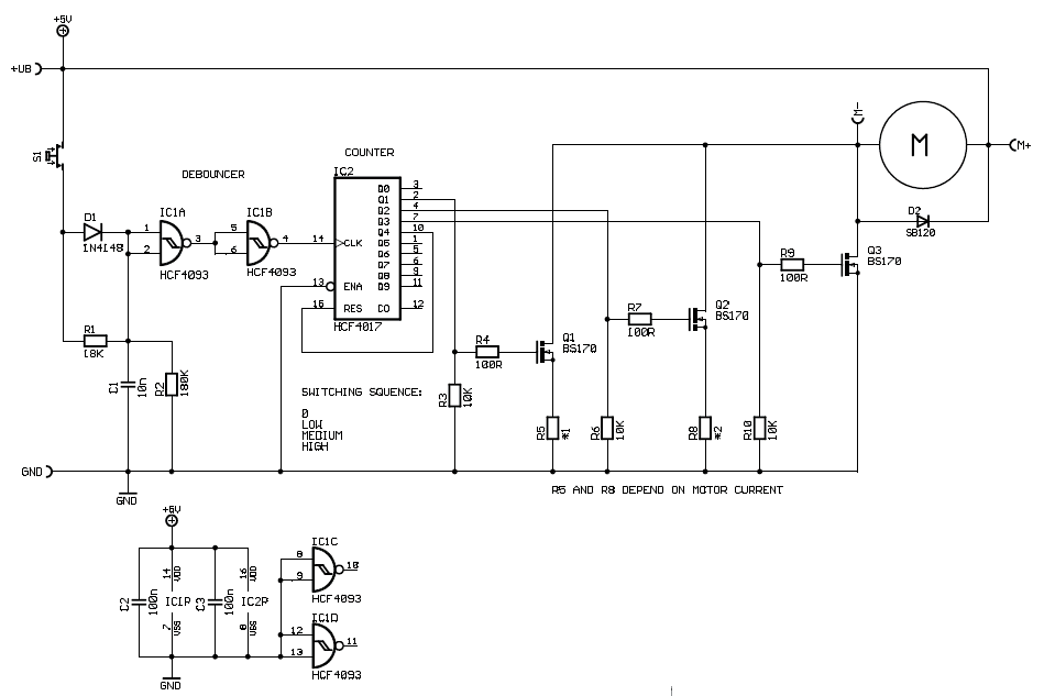

Hi ryukyu,
I guess it's a small fan with low current.
Here is a schematic and PCB design for a fan not drawing more than 500mA of current.
The circuit contains a button debouncer (HCF4093) and a decimal counter (HCF4017).
I assume you also want to switch the fan off.
When energizing the circuit Q0 of the counter will be high. Since there is nothing connected the fan will be off. Pushing the button increases the counter output to Q1 (lowest rpm) and so forth until highest rpm at output Q3. One more button push resets the counter and the fan will stop.
R5 has to be dimensioned to have the motor start safely from stand still. R8 should be for medium speed. T3 has no current limiting resistor which should result in full fan speed.
The PCB design is purely single sided and measures 2.86X1.5inches.
Boncuk
