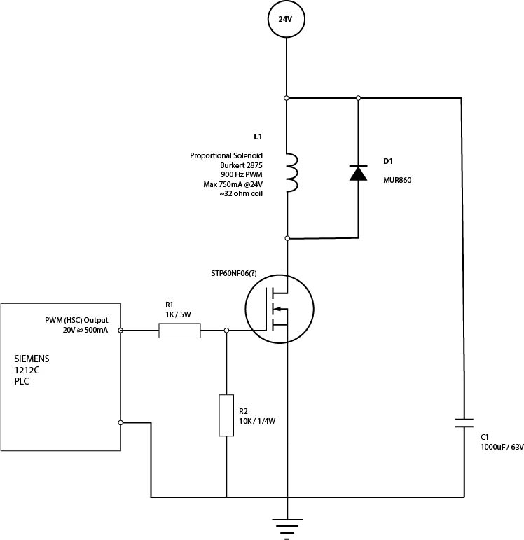

I am working with a Siemens 1212C PLC and looking to power a Burkert proportional solenoid via the PLC HSC outputs. Smaller solenoids have been successfully powered this way, but I need a bigger orifice size which requires a bigger solenoid. The maximum rated output of the PLC is 20V @ 500mA (ON) and the Burkert 2875 requires 24V @ 750mA to fully open. (In the smaller valves the 20V maximum is very nearly fully open and an acceptable compromise). Rather than add expensive AD/DA modules, is there a basic current gain MOSFET / transistor amp that I could employ? I'm not that familiar with transistor design, but have added a simple design that may work (?). I have a 24V supply to work with and don't need a big gain ~x2 current, and ideally a small voltage gain (which this design certainly won't provide). It's a 900Hz signal, so I imagine it can be a very simple circuit - added C2 to tune the output to a square wave and C1 to add some local capacitance. No doubt missing a diode.
Can anyone point me in the right direction? I have some IRF540N in the drawer, so if that works for easy prototyping - great!
Siemens 1212C
Burkert 2875
Thanks for any help,

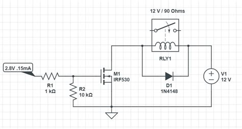

"Normally" you would use a circuit like this with NCHAN MOSFET -
I would advise R1 somewhere in range of 50 - 100 ohms. Using a scope you tune that value to
minimize ringing at MOSFET gate.
D1 is used to protect mosfet from damage due to inductive transients generated by valve
coil.
Your IRF540 OK choice for MOSFET although I might be tempted to use a 200V part
for additional margin under transient stress.
D1 should be a 2A, 200 V rectifier, reasonably fast recovery. In4148 shown simply not adequate.
Regards, Dana.

Will one side of the solenoid be referenced to ground or +V?
I wouldn't recommend IRF540 as it would be operating at max VGS (20v).
I concur with etech, glad he caught this, you should get a part with a higher max allowed Vgs.
Say a 40 - 50 V part should be plenty of margin. Or use a R voltage divider at input to MOSFET
to limit Vgsmax applied to MOSFET gate. You could replace the 10K with 300 ohms, the series R
at 100 ohms, that would cut down Vgsmax applied to ~ 15V (if the lightly loaded PLC output
stays around 20V. Or even use 100 and 100 for the divider to supply 10V as gate drive, the IRF540
ratings for Rdson are at 10V Vgs. However the Rs have to be 2W + some margin at high duty cycle,
eg. valve fully open. You can tradoff their wattage for speed of turn on of the MOSFET, eg. raising
them to higher values. Juggle the numbers to get a satisfactory answer.
The PLC is rated at 20V at load, so would be higher when just driving the MOSFET after its charged
its gate capacitance.
coil.
Regards, Dana.

Thanks very much for this - I have redrawn it for my monkey brain to understand:
I have some MUR860 in drawer, and the STP60NF06 is available in store locally. I also added some local capacitance (C1) to help out power supply - needed?
Do you know the PLC PWM output frequency when running ?
I can set this - anything up to 100kHz, this Burkert is specified at 900Hz, and I have driven the smaller units direct at 750Hz.
Thanks again.
My 24V comes from 18650's via an LM2595 boost converter, there's a 100uF on the output, and nothing else added - but again, it depends on the exact circumstances.
Why is R1 5W in your diagram above?, also 1K is rather high for fastest switching. Is the STP60NF06 OK with 20V drive to the gate? - my drive is only 5V from a PIC - it's spec says +/-20V maximum.
Thanks again.

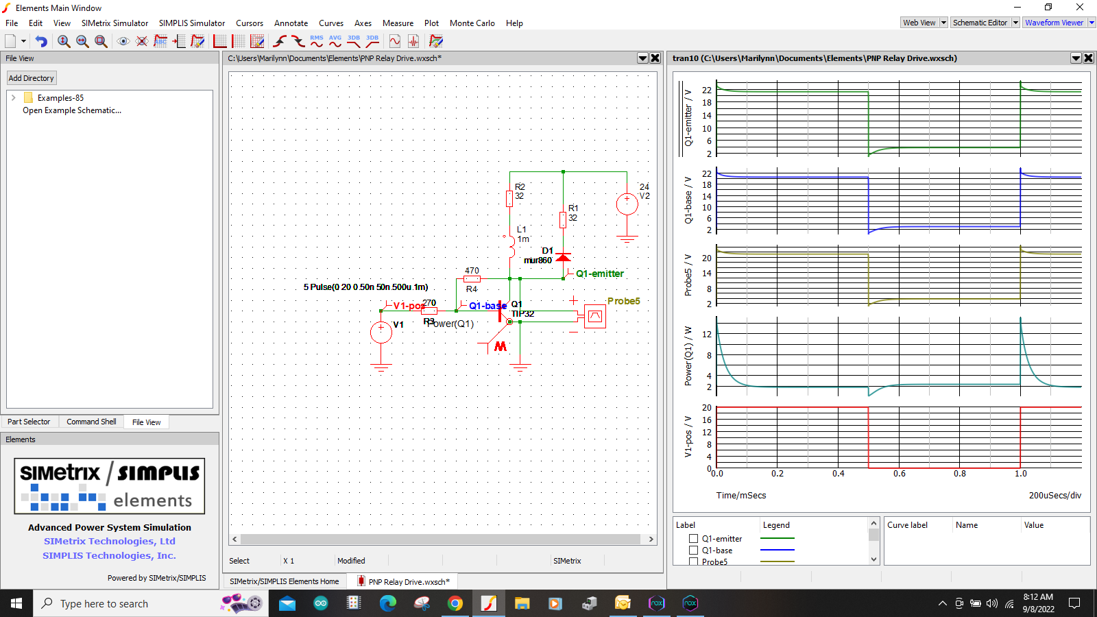

Circuit seems to work well although TIP32 not getting saturated,
maybe a little excess power getting consumed -
Did not know relay L so "picked" 1 mH as a reasonable
value
Regards, Dana.

I used the post in post # 10, now saw the additional comments., so
Q1 not fully sat nor fully turned off when off. Due to R4 and V2 - V1 >= Vbe due to
divider .
And we can see due to large L of solenoid it never really changes valve oposition that much.
Would have to lower PWM freq to allow time for decay.
Regards, Dana.
Looking at L (relay) current not fully off because PLC cant generate 24 Vdc
to fully shut off Q1 Vbe. Either drop 24V to 20 or use NPN/ NMOSFET
as you redrew in post #9. With series Gate R dropped to 50 or more ohms.
Or drop 24 to 20 with a 4 V 5W Zener, on a heat sink. I would fuse the 24 V line....
just a thought.
Here is sim with 24 Vdc changed to 20 Vdc
Relay shuts off.
Regards, Dana.
