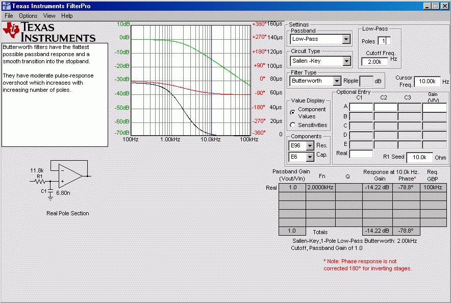

You need a much more aggressive filter. The light green trace (n010) is yours. Compare that to mine....
Thank you, Mike.
I'm only a beginner: Can you explain how to read your graph?
More importantly: What happens when I hook up my simple RC Low Pass Filter? What does it do the signal that just turns it into noise? As a beginner, is there a simple solution I could do on my own (that is, I don't want to just copy someone else's circuit).
Ok, the circuit I simulated I just threw together to create a PWM. Note V(in) red trace is a 0.8Vp-p 1Khz sine wave fed to one input of a comparator. A 37KHz trapezoid wave V(n003) lightblue is fed to the other input. The comparator creates the PWM signal V(pwm) purple trace.
The PWM signal is attenuated a bit {just to match the amplitude of V(in)}, buffered, and fed to your simple RC filter consisting of R9 and C5. V(n010) lightgreen trace is the output of this simple filter. Note the tremendous amount of carrier feed thru because this filter does not provide enough attenuation at 37kHz. This is your "noise".
I also take the PWM signal and pass it through a filter that has much, much more attenuation at 37kHz. The output of that filter is shown as V(out) blue trace, overlaid on V(in) red trace. Except for a little phase shift, note that they compare very nicely.
Basically, the low pass filter must have many tens of db of attenuation at the carrier frequency, while passing your audio range, which your simple RC filter does not...
A simple 1-pole 10kHz filter has less than 12db of attenuation at 35kHz, thus attenuating the carrier frequency by less than a factor of 1/4 (each filter pole gives 6dB/octave of attenuation). For a reasonable minimum signal to noise ratio of 40dB you need a factor of 100, requiring at least a 4-pole filter, which is what Mike simulated.

There is a lot of information out there on the subject of filters. To create the active filter used in the simulation, I used the free cad program called FilterPro, downloadable from TI's website.
You can run it and put in various filter configurations. It even plots the attenuation and phase shift through the proposed filter. For example, I just ran a simple 1 pole RC filter like you just proposed. Note that if you move the cutoff freq to 2kHz, the attenuation at 37kHz is only about 25db (slightly more than a factor of 10), so it would still have 10% carrier feed through...
Note that in the simulation I posted, I used FilterPro to come up with the values for the 4pole filter, and then I moved them to LTSpice. I was able to explore the filter requirements without building your circuit. Now if I was trying to come up with the entire IR communications system, I would eventually build a breadboard circuit, but only after simulating/optimizing it first.
