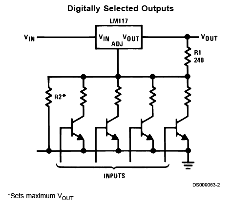

Hi I also earlier planned to use different resisters to ADJ pin via different transistors.
Like in the national datasheet.
But if I need 12 values I need 12 transistors? Oh no I don’t like that.

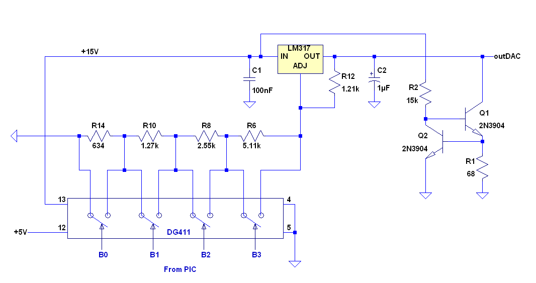

The four-resistor circuit as I think we were imagining it turns out to be more complicated than we thought. In order to get equal-sized steps, the resistors have to be in series, but the switches have to short each one out individually. See below.
If anyone has a simpler scheme, please post it.

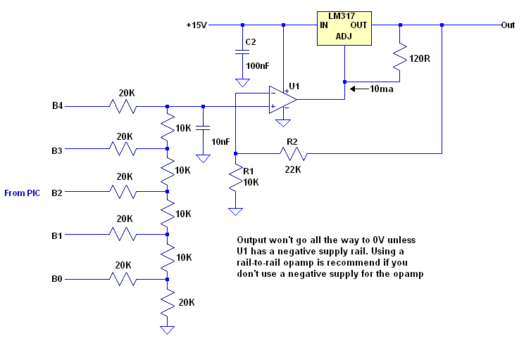

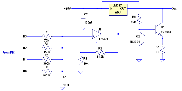

I have added a circuit using a simple resistor DAC with an op amp buffer.

Well it is a lot simpler. You simply drive the transistors with the pics output pin. If he needed only up to 6V even the transistors could be lost and replaces by the direct connection to the PICs pins.
Here 4 bit acuray is used that mean you have 16 different voltages selectable. If you use 8 you get a big 256 different values. It just doubles with every extra bit.
EDIT: Oh and this is from the LM317 datasheet by National Semi. page 18

The National circuit will work fine for four output levels, but I don't think you can combine them in binary fashion to get equally spaced steps. I didn't try all combinations of resistor values (only binary ratios), but I think the steps will be sort of logarithmically spaced. Do some simulations or calculations before you jump to any conclusions.
I had a play in excel and you are correct that the steps aren't linear but with the right resistors the required 12 voltages may be possible. Sheet attached, zipped as xls not allowed.

I like to build Rons circuit that opamp thing.I understood that .But I'm having difficulties calculating the input 4 resisters.This weekend I'm going to study it.
After knowing the correct concept I like to build the LPF method also.A non linear output voltages also a problem.Mikes graph showed them.
The way to do it would be to make an R2R network to feed the opamp. This makes things easier as far as finding resistor values goes:
Resistor Ladder - Wikipedia, the free encyclopedia
The Wiki page shows you how to calculate the output voltage steps of the R2R ladder. You could use the standard 1% resistor values of 10K and 20K for the ladder. Then you would adjust the gain of the opamp circuit so that you get 0.5V steps.
For example, if you built the 5 bit R2R network, the step would be 0.15625V if running the PIC from a 5V supply. So you would need to set the gain of the opamp circuit to 3.2 for 0.5V steps on the output.
