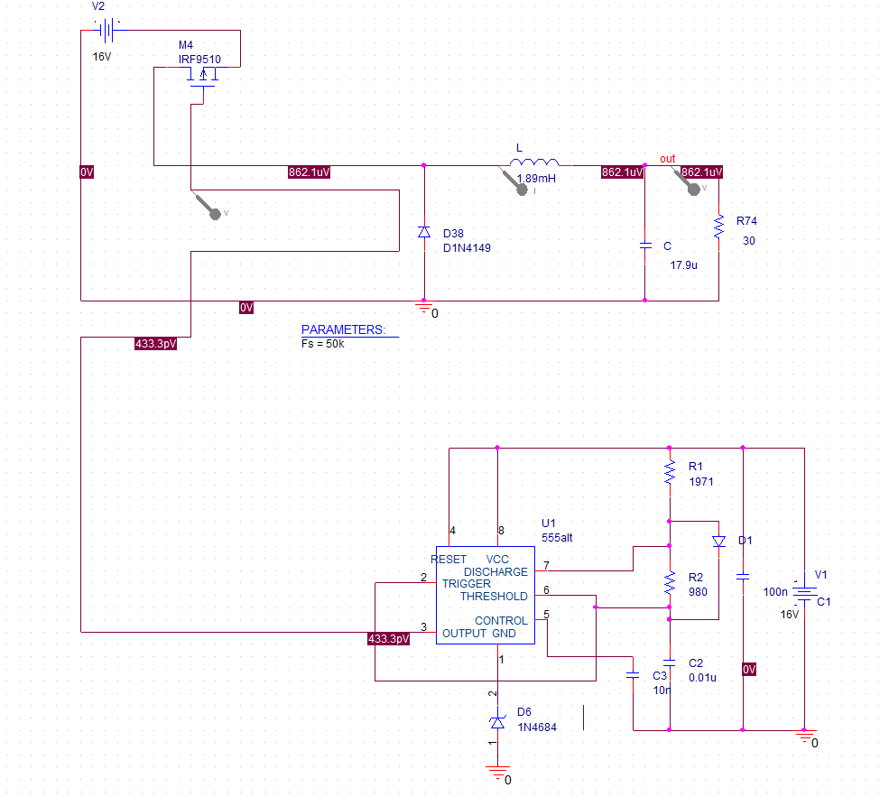

Hi guys, basicaly my PWM is giving an output of 3V and 0V using a 555timer... my gate of PMOS needs 16V to switch off and at < 10V to switch on... i need a solution to boost the OUTPut voltage of the PWM so i can get +19V and +9V..
ive tried op amp.. but the output of my PWM changes from square to triangle..thanks in advance guys

im using ts555cn... welll i know wad u r trying to say... but when i build it on the verobard.. and increased the voltage of the supply Vcc the output voltage didnt increase much... 16V supply gives around 6V... btw i dont under wads high side and low side.... could you explain hehe?
And also the reason y i changed to PMOS was that the voltage i need on the gate using NMOS would be very high... and i need to connect the source of NMOS to ground using that topology... we'lll im attaching my whole circuit...hope to get some reply soon :)
works with simulation.. but on veroboard... not quite :(
Actually I have another current mirror the control the duty cycle but its not included here...

What frequency/duty cycle is the 555 running at?
How much current can the CMOS version of the 555 source and sink?
I'm guessing that the CMOS 555 can not charge/discharge the gate and Miller capacitance of the PFET at the rate you are running it. The NPN version (LM555) can source/sink 200mA. Yours, maybe 8mA.
well my duty cycle would be controlled later on using a PIC controller.. the duty cycle of the 555timer should vary from 40~70%.... so i can adjust the output of my buck.. er... im not sure about the current.. well the output shows +3V and +0V which is insufficienct to on/off my mosfet... my PMOS theoretically and from simulations needs at least 16V to turn it off..

Like I said on the other website, the Cmos 555 does not have enough output current to quickly charge and discharge the high gate capacitance of the Mosfet. use an ordinary 555 instead.
The lousy old LM324 opamp that you used has terrible performance above only 2kHz.
Your 50kHz frequency is far too high for your parts.
The zener diode raises the "0V" pin of the 555 to +10V so that the gate of the P-channel Mosfet can be driven from +10V when it is turned on to +16V when it is turned off.

Nearly every semiconductor manufacturer makes an "ordinary" 555 that has a design that is about 40 years old. Its max output current is 200mA. If you use one then an opamp amplifier is not needed.
A Cmos 555 is newer and has an output current of only 10mA high when its power supply voltage is high. 10ma is not enough current to quickly charge or discharge the high gate capacitance of a Mosfet so high frequencies are a low level triangle waveform that do not work.

The internal resistor divider of the 555 is referenced to the GND pin (at 10V) but your timing components are GND referenced.
