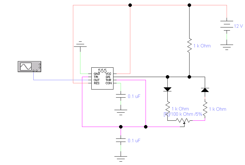

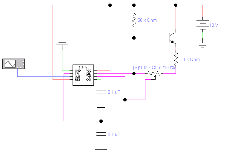

ok just check this schematic out for me I simulated it with elctronics workbench 5.12 and it works exept that for max and min pot after a second the simulation jams but I would say that that is a software limitation on the program. it seems that I can get a 0 % straight thru to 100 % duty cycle. the idea is to speed control a motor.
is there another way of doing it with out the transistor or have I hit the nail on the head for max duty cycle range ?

ok I just played around with diodes in the circuit and got the exact same result

I looked at your circuit and it seems to me that you're achieving duty cycle adjustments by having a variable ON time and a fixed OFF time. This results is very low frequency when the duty is close to 100% and the PWM frequency goes up to maximum as the duty cycle drops to 0%.
There are applications when this is undesirable. The frequency can go up to where switching losses could be intolearable. Or the frequency will drop to audible levels and there will be an annoying hum from the motor.
there is no drastic frequency change. the total off+on time is constant becase one part of the pot is used to charge and the other to discharge. the transistor is keeping the supply cut off during discharge as if you look closely the pins that sense the voltages on the cap while it is discharging will be subject to a voltage devider that upsets the circuit and recs havoc. the result is the same as the secon circuit where diodes are used to seperate charge and discharge sections.
so the diode solution is probably best. just one question though: a diode can only work up to like 200 Hz or is this not a problem because it is all DC so no reversing and rereversing problem ?

What makes you thing diodes are limited to only 200Hz?, diodes are available that equal (or exceed) transistors.
Normal slow recovery rectifiers are only suitable for low frequencies, but that's what they are designed for - a diode (such as a 1N4148) will massively out perform a 555.
BTW, the two diode trick for adjustable mark/space is a VERY old technique, and is probably shown on some of the datasheets?
yea i suppose it is i remembered seeing it in my school electronics book that just reproduces component datasheets. i couldn't remember hoe it was done and came up with the transistor solution first but having understood what was going on I worked out the diode solution for myself
