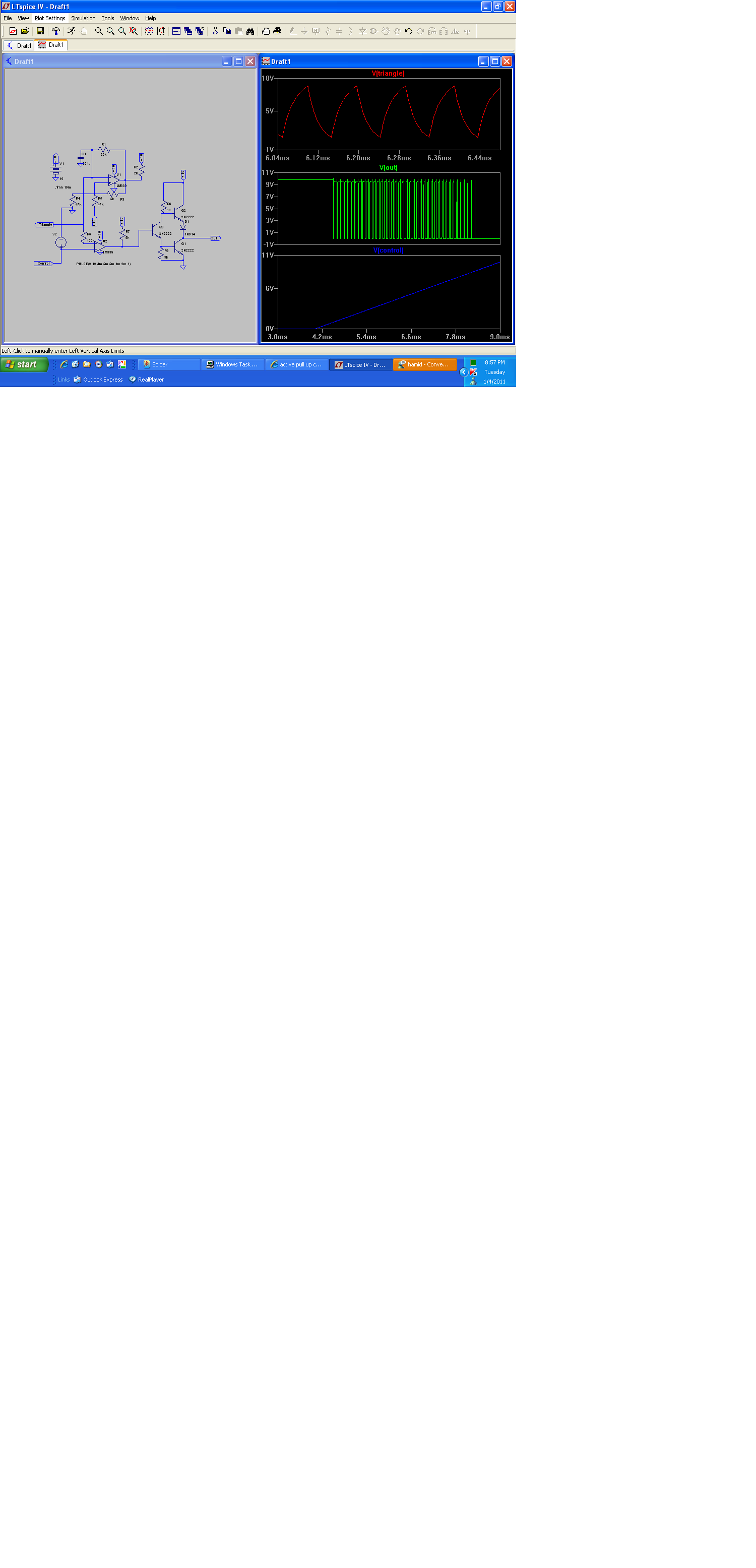

Pwm
Here is a similar circuit that uses the other half of the 339. If you don't need the active pull up you can replace the totem pole output with a transistor. As is you need to decouple the positive supply just like when using the 555.
