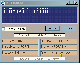

Look at this simple asm program I have posted, it will run.
It has some comments that should help you understand it.

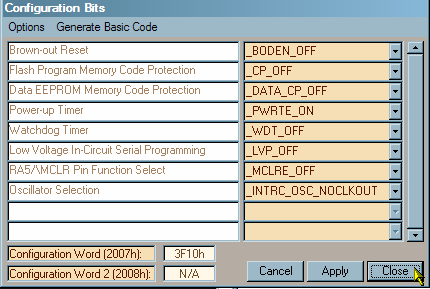

What is the crystal frequency of the PIC 16F628.?
So you have programmed the 16F628 for INTRC at 4mHz.?
My circuit has only PIC and a regulated 5V input beside the LCD connection. I've just put your program into MPLAB and obtained a Hex file that I put it into the PIC. Frankly speaking I don't know How to set INTRC into the required Frequency.
You need the same wiring connections to the LCD if you use the test.asm I posted.!
Change the program LCD initialise to suit suit your LCD wiring.
Also set the program for INTRC.
It works OK for me, using my LCD pin wiring
