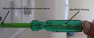

My apologies to you both. The only neon tester I have had experience with is the screw driver type.
That is why I asked for clarification.
A point of interest: I built a power supply when I was younger that used a neon to indicate when power was supplied. The neon did not light up when I turned on the 240 vac.
I sought help and my foreman who told me to double the value of the in-line resistor. This done; the circuit worked correctly. This surprised me as halving the current through the neon
allowed it to glow. Hence my skepticism in using a neon as a voltage tester. Yes... the original design was for 110-120 vac.
Your tester must have additional circuitry that gives it such a range of detectable voltages.

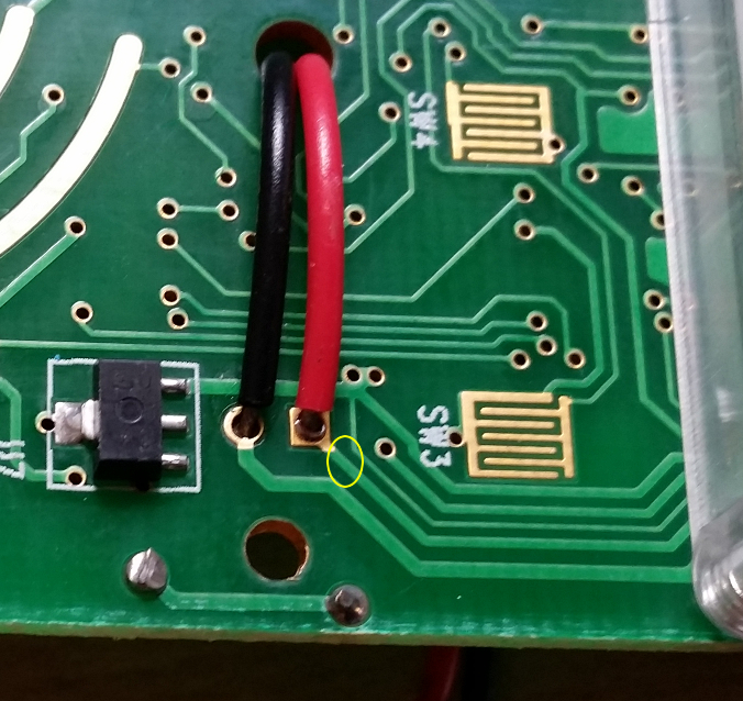

I have this meter. It's definitely an non-contact AC voltage detector circuit that is on all the time. There is circuitry on board that drives the red LED. This runs off the 9V battery in the device. The unit is really sensitive pretty much any EM field, and any AC voltage or moving magnetism will trigger it to some extent. This is why bumping it so often makes it flash, and those that have seen it flash regularly (eg: every 30 secs) probably had a mobile, cordless phone or some other wireless device (cordless mouse/keyboard, wifi, etc) near the device at the time.
The big killer for me is that I carry this thing around everywhere and by the time I go to use the meter, the battery is flat. The battery is behind a plate held in with 2 (small) Phillips screws, so it's non-trivial (not to say annoying) to have it in your kit without a battery in it. I've had brand new 9V batteries go flat after going through 3 airports (and a bit of driving) in check-in baggage, which renders it useless on-site. I now use rechargeable 9V batteries, but they still take time to charge after going flat in the device.
I've "pretty much" figured out the trace that runs the whole detection circuit and found a switched version of the battery line from the knob, so I'm going to try and see if I can make it work only when the unit is not in the OFF position. I've taken some before photos and will post a few pics of what to do if it works.
FWIW: I can't see how such a change would affect the CAT III-600V rating, as this circuit is directly connected to the 9V battery all the time. Applying a high voltage to a 9V battery is more likely to cause problems than putting it through the rotary switch on the device. Also, the rotary switch is connected directly to the 9V battery + line (on a common pin to all settings, even off), means it's connected anyway. That said, I don't deal with anything that high in voltage, so I don't see it being an issue for me.

Success! I've got it disabled by cutting one track and running a wire.
The track to cut is on the LCD side of the PCB. You need to remove the battery door (2 screws), the 4 case screws, and then 6 screws that hold in the PCB. There are 2 screws that hold in the LCD, so you don't want to remove those. The LCD screws are the second set down from the top (LED) end of the meter.
Here's the track I cut (circled).
Pic 1:

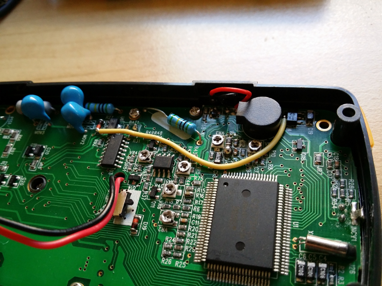

...and here is the wire I ran.
Pic 2:
The anode of the diode D8 goes through the rotary switch to the 9V battery positive. It's connected for every rotary switch position except the middle (OFF) position. This seemed the easiest place to tap it off after the switch.
I ran it to the common pin on U4, which appears to be a FET. This is where the cut track runs to, and is where the non-contact AC detector circuit gets power.
I've tested it and am happy with the result. The non-contact AC detection works fine as long as the switch is not in the OFF position (doesn't matter what mode it's in), and all other modes work (see note re: Buzzer).
Note: If you cut the track but do not connect the wire you will have no buzzer, even for the buzz test mode. I wasn't willing to take components off the board to figure out where the track ran. Anyway, this stops the unit "squawking" when the battery is low (which just makes the battery flat faster - and really annoys airline security staff, let me tell you!), which I've heard it do even when the switch was in OFF position. As a consequence, I'm expecting to get a lot longer battery life out of it now, and annoy a lot less airline security.

Can't help commenting on non-contact testers, as there is so much ignorance and misinformation flying around in this thread on that subject.
Where have y'all been the last ten years or so? The non-contact testers that folks use nowadays (speaking as an electrician, i.e., someone who works with 120 vac), do not use neon bulbs. Those are the old-school types. The newfangled ones (which actually aren't all that new, having been around for at least a decade or so) are little pen-shaped thingies with a bunch of electronics inside which light a LED and beep a beeper when they detect nearby live wires. All the ones I've seen run on a single AAA cell. They have no exposed metal parts; the "probe" tip is plastic, and they don't need to be placed in contact with a live conductor. Putting them up to an energized outlet is enough to set them off (or next to a "hot" wire). Safest way to determine if something's live or not; I call mine "the lifesaver". So that's what's inside those multimeters, not a neon bulb.
Sheesh ...
A "lifesaver" with a little AAA cell that soon goes dead will KILL you. I trust my neon bulb testers that use no battery.
Well, duh, you make sure it's working first before you trust your life to it, by putting it up to a known live device or wire, and replacing the battery as needed.
Your neon-bulb testers aren't anywhere near as sensitive (nor even as reliable) as the non-contact testers everyone else uses nowadays.
