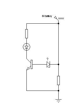

I want to make a circuit which lights up a led when the 6v battery is fully charged. So i need to know what is the value of the voltage of 6v battery when it gets fully charged. And which value of zener diode should i use?
If you had read the references we provided you, you would understand that there is no magic voltage that says a battery is "charged".
A lead-acid battery is fully charged when the current it draws from a constant-voltage charging source drops to a few tens of mA while the battery terminal voltage is held at 2.4V per cell (7.2V for a three cell battery).
At the point the battery first reaches 7.2V during charge, it is NOT fully charged; not even close.
Like MikeMl said:
"A lead-acid battery is fully charged when the current it draws from a constant-voltage charging source drops to a few tens of mA while the battery terminal voltage is held at 2.4V per cell (7.2V for a three cell battery)."
can you tell me what will be the zener diode rating if i use this circuit for 6v battery? . . . .

Like ST said, your link in post #10 doesn't work. So there is no way to tell you what zener to use if we don't know the circuit.
And, like Mike has said, a lead acid battery is NOT fully charged when it reaches a certain voltage. You need to monitor the CURRENT.

As soon as the battery voltage exceeds the point at which the zener conducts in that circuit you will destroy both zener and transistor, because there is no current-limiting resistor in the zener path. For reasons others have stated above there is no zener voltage which would be satisfactory for measuring charge state with such a simple circuit. You need to monitor charge current, not just voltage.
Thanks all. . . .thanks to MikeMI, MrAI and alec_t for your valuable comments. Now I'm clear that i have to play with current not voltage . . . . :D .

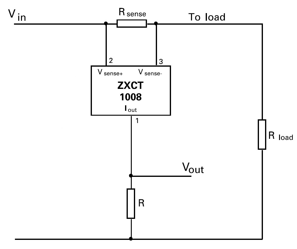

MikeMI suggest me to use zxct1009 to monitor charging current to know the battery is fully charged or not. I saw the data sheet . Here V(sense) is equal to V(out) and R(out) is greater than R(sense). Am i right? So when battery is fully charged, charging current will be decreased. As a result V(out) should decrease also! If i am right then is there any way to turn ON a led using V(out) when the battery is fully charged (without microcontroller)?
No. V(sense) is the voltage dropped across Rsense by the load (charging) current. V(out) is the voltage across Rout by Iout.
Probably. But it doesn't have to be.
