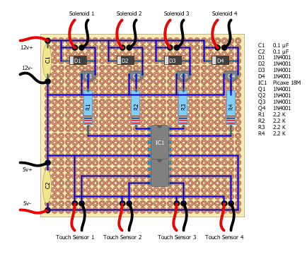

Ron, can you explain how you calculated the value of the resistor? The solenoid i'm testing with is likely to be different the one I eventually use. I expect the 12v to remain constant, but the watts required may change.
Also, how many of these solenoids could I control with 1 chip. The specs of the chip i am using say that it can source (or sink) 20mA per pin, with a maximum of 90mA for the chip. Does that mean I am limited to 4 solenoids per chip?
Lastly, would you mind taking a peek at my latest layout to see if I've placed the bypass caps correctly?
Thanks for your time & help,
-Scott
Solenoid looks fine but... Looks like you are powering your PIC with 12 volts so not good. :) The bypass looks just fine. The trick is as close to your PIC power pin as possible.
As to the base resistor, try giving this link a read. The first few post cover it well. So yes, the load makes a difference.
How many solenoids? That depends on how you configure them. Meaning if you wanted to fire 4 or 6 or whatever all at the same time then you would consider a larger transistor and parallel your loads (solenoids) or likely use a MOSFET as a switch to handle the high load of all the solenoids. However, if you want to fire your solenoids for example sequentially (at different times) from your PIC then you need to figure the base emitter current you draw for your transistor(s) and work from there. I guess we could say it's all about current.
Wooops... I fixed that on my layout to avoid confusion. Copy/Paste fail! Thanks!
Well, 5-8 solenoids total, each able to fire at any time. All connected solenoids might be active at the same time. I thought I would need a MOSFET for each solenoid? The attached layout was me working on the assumption that 4 is my max.
EDIT: Note IC1 & IC2 are actually just 1 IC... Picaxe 18M. The software i'm using doesn't support 18 pin ICs so I used two next to each other to simulate 18 pins.
Thanks again for all your help!!
-Scott

Now your layout looks good. OK, as to the base resistor thing, maybe give this link a read. I believe it will cover it all.
Pay attention to hFE which is the beta or current gain of a transistor. Remember a transistor is a current amplifier device. It's all about current. The purpose of a base resistor is to limit the base current through the transistor. We want to use the transistor as a switch in this case, so we say we want to drive the transistor into saturation where the collector to emitter is for all simple purposes a straight line with zero resistance. Now the trick in choosing a transistor as a switch is to make sure the emitter collector junction can handle the load current. If our load is a solenoid and @ 12 volts that coil needs 200 mA to operate we have a 200 mA load. That emitter collector current is a key player in figuring out the base resistor. That should become apparent in the link.
So if we have a PIC and want to drive a solenoid we need to shove a transistor in there to turn on the load. The PIC alone (in most cases) will not be able to drive the load by itself. The source current of the PIC is considerably less that the current needed to drive the load so we need a current amplifier and enter the transistor.
Most of this is a little difficult to grasp at first but it does all come together and easy to grasp.
Remember the hFE is really nothing cast in concrete and the base resistor isn't an exacting down to the ohm science. When used as a switch we just want to make sure we drive the transistor well into saturation but do want to limit the base emitter current so we don't cook it.
Ron
