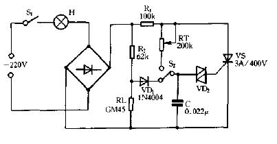

This is a lamp circuit, you can refer to it.
Okay so I get the idea of controlling the conduction angle, but I still don't understand how to control it or adjust it physically. Can somebody help me up with that ?

You can't control a switching diode like that. A diode conducts when it's forward voltage is above about .5 volts and stops when the voltage drops bellow .5volts you can't control when it switches. What you need is a transistor. I can understand why you would have trouble trying to turn it on and off from the power supply the filter capacitors would give the curve you describe. The first thing you have to answer is how much current this pulse is going to have to deliver because that will determine how you can switch it, from there we should be able to recommend a transistor. A simple 555 timer circuit would easily produce the pulse you're talking about and be easily controllable which would be fed to a transistor to control the actual pulse from the main power supply, it all depends on the current as to what should be used.
