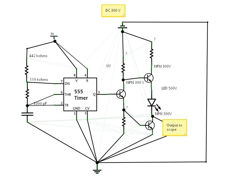

Here's the circuit that I'm thinking :

That's not gonna work for several reasons, I'm playing around in my simulator now, I'll respond shortly. Sorry for the broken/distracted posts I make, I'm not used to headlining a thread, other users usually chime in at some point and by now someone has generally taken over helping with the schematic so I'm not used to it =)
One big thing is can you describe in much more detail what this is actually going to be hooked up to? For testing using a scope is fine, but figuring out the actual load itself specifically it's resistance and capacitance to ground is getting pretty important as it will effect the performance of the circuit not to mention weather or not it's actually physically possible.

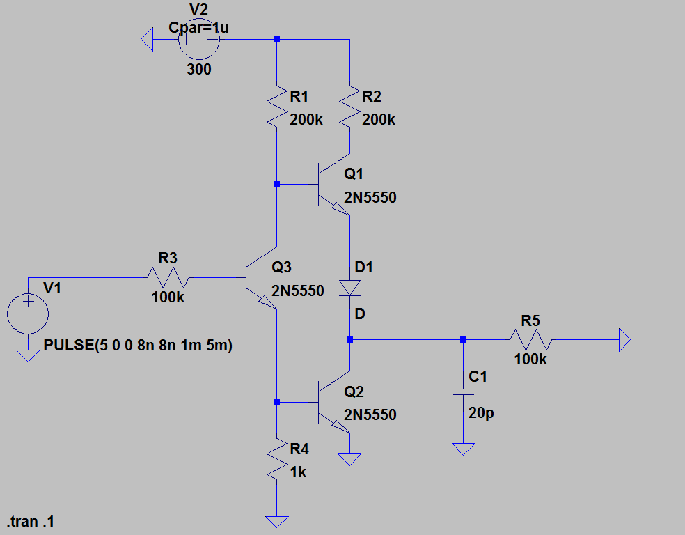

This is a rough schematic I worked out simulating and playing with values, nothing blows up, it's pretty safe, resistors are 1/2 watt. But the load itself determines the rest. The components are really just 'stand ins' for what you intend to actually use as far as the transistors and diode goes.

It is gonna be hook up to an electrode of 25 mm by 2 mm of gold. Thickness is about 1 mm.

That doesn't describe the environment it's actually in though, what's near it, is it metallic, liquid, otherwise conductive etc.. You'll have two main power draws, conduction to ground, and capacitance to ground. You have to name every other electrically interactive substances within at least a few inches of it which is pretty much EVERYTHING. Is the electrode submerged in a liquid, etc.. etc.. There is nearly an infinite number of permutations you could put that electrode size through and come up with a vast different number of situations, and the component values you chose for that particular type of circuit will require you to know the ACTUALLY load you're applying it to if you want the full 300 volts.
I simply have no idea what to even guess randomly at as I'm not a biological engineer with an EE degree => I'm guessing very low resistance, maybe 1meg and moderate capacitance, perhaps 1000p but I'm only guessing. If that's the case connected to 300V the circuit I listed will provide approximatly 270 volts to the load. If the capacitance is lower it'll be higher, if the capacitance is higher it'll be lower. If the resistance is higher the applied voltage will be higher and lower if lower.

The above circuit should work fine, remember the two points. One, you will not get the voltage you want at the load if it has a higher resistance to ground than about 100k, capacitance isn't going to be too much of an issue because the strip isn't large enough to make it one. Two, the input from the 555 is inverted, whenever the output of the 555 is low the circuit will output the high voltage and vice versa. This just requires you to change your values for your 555 circuit, you should find plenty of calculators out there on the net to help you with that.
