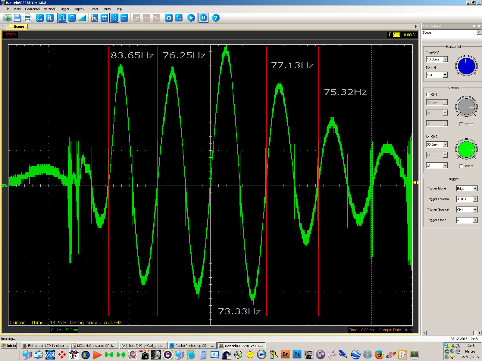

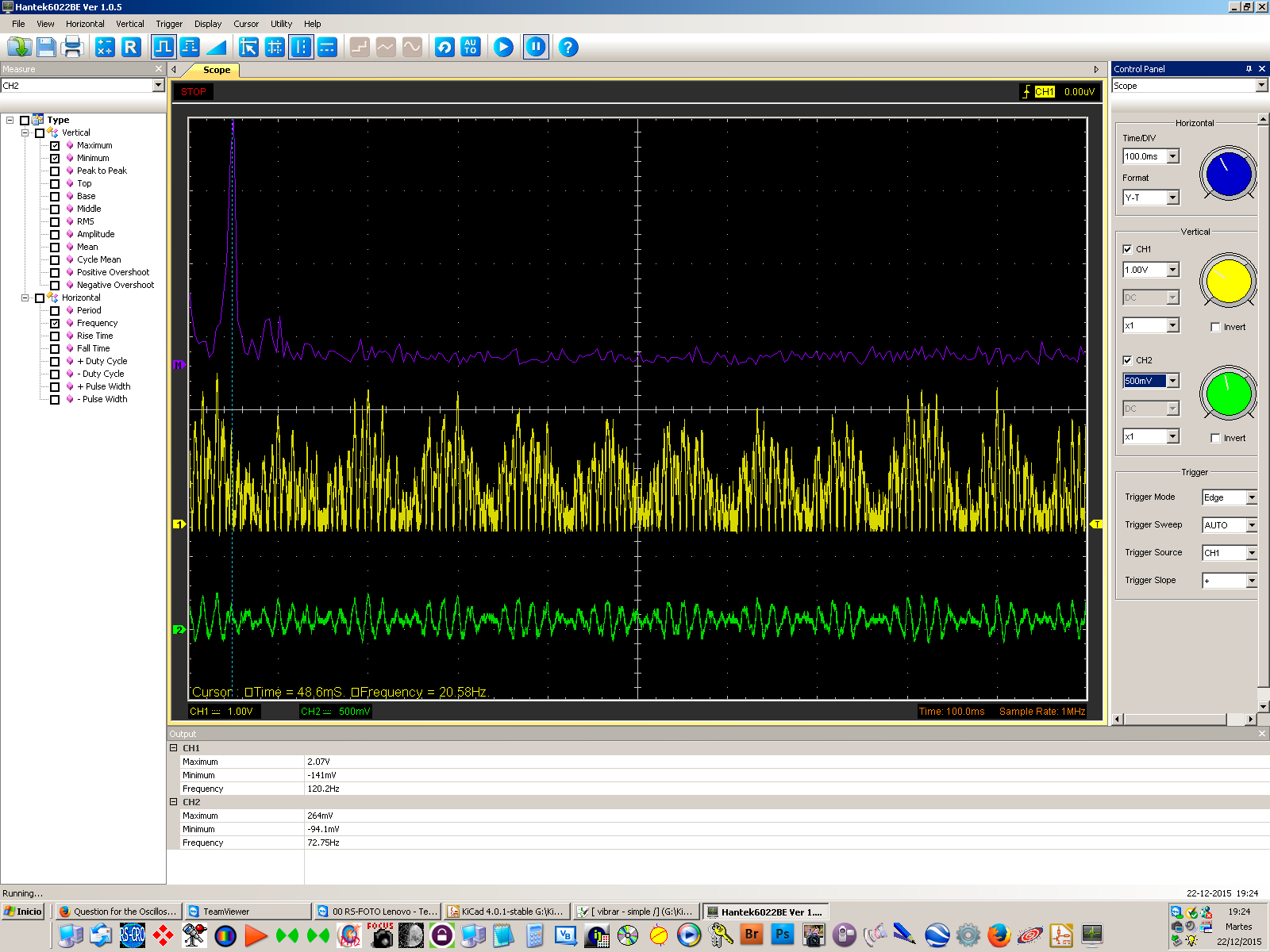

Your new 'scope photo shows 3 cycles every 50ms which is only one frequency and it is at exactly 60Hz which might be electrical hum picked up by your wiring or caused by a synchronous AC motor driving the telescope movement.

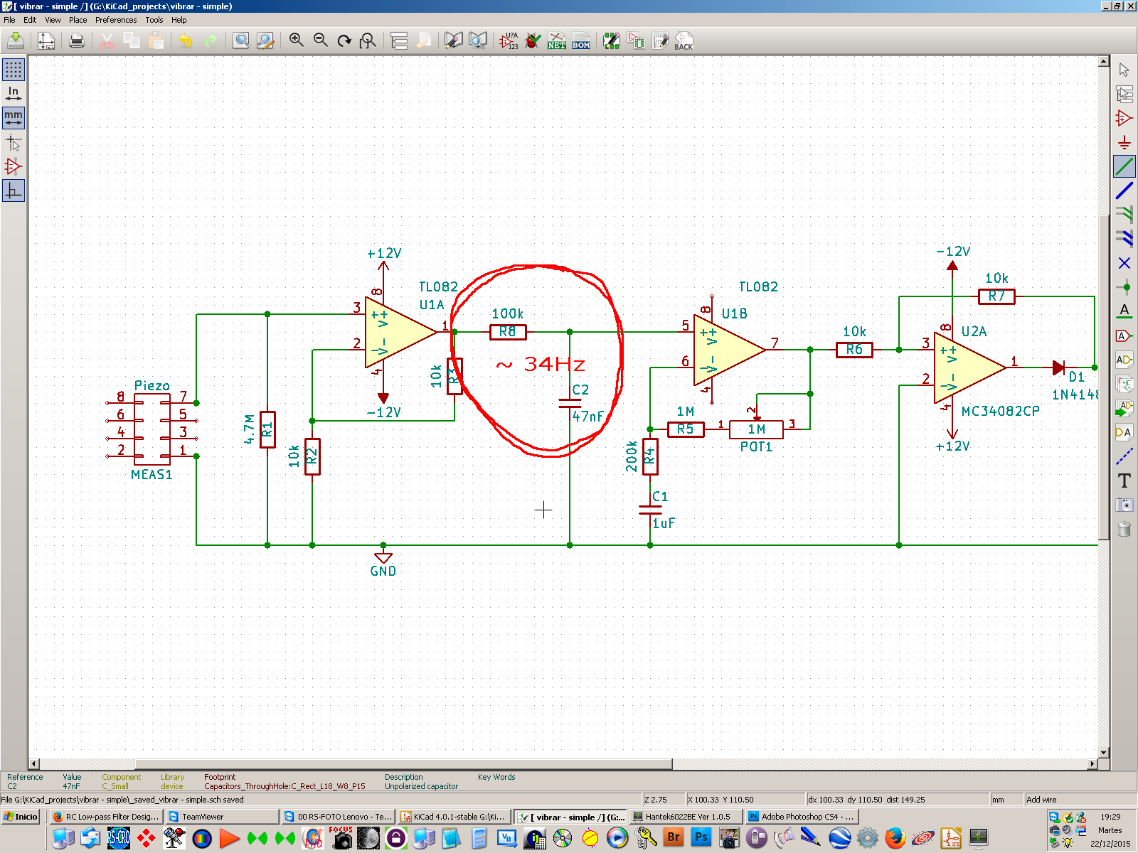

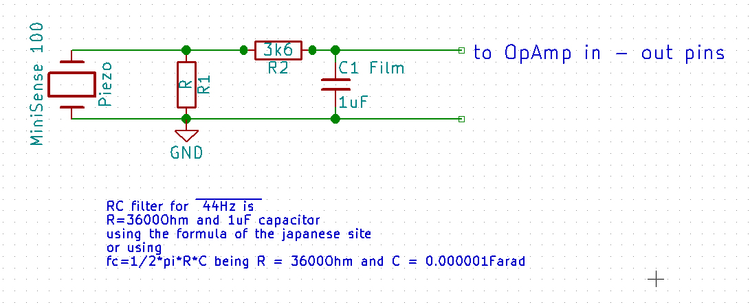

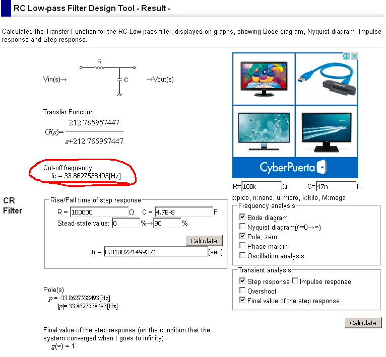

The Japanese site and many other sites show how easy it is to make an RC lowpass filter and a CR highpass filter. When the filter is made properly then it has no attenuation to the frequencies you want but it cuts the frequencies you do not want. You did it wrong then it reduced your sensitivity.
1uF is a fairly high value but the signal to it is AC so it cannot be an electrolytic type, it should be a film type. Why 1uF? Why not use 0.1uF if you change the resistor value also 10 times.
A 0.1uF film capacitor is small and inexpensive and connect it with a 36k resistor. It is the simplest lowpass filter called first-order. At 44Hz the level will be 0.707 times the very low frequencies levels.
That will be a horrible filter. Its output will be -12db (0.25 times) at the cutoff frequency and it will be very droopy and still reduce almost all vibration frequencies. A Sallen and Key filter uses an opamp to boost the response at the cutoff frequency so the cutoff is very sharp above it and it does not attenuate lower frequencies.If I chain 4 of my LP filters using the 100k and 47nF caps I get a 4th order LP filter, but with what sort of problems ?
