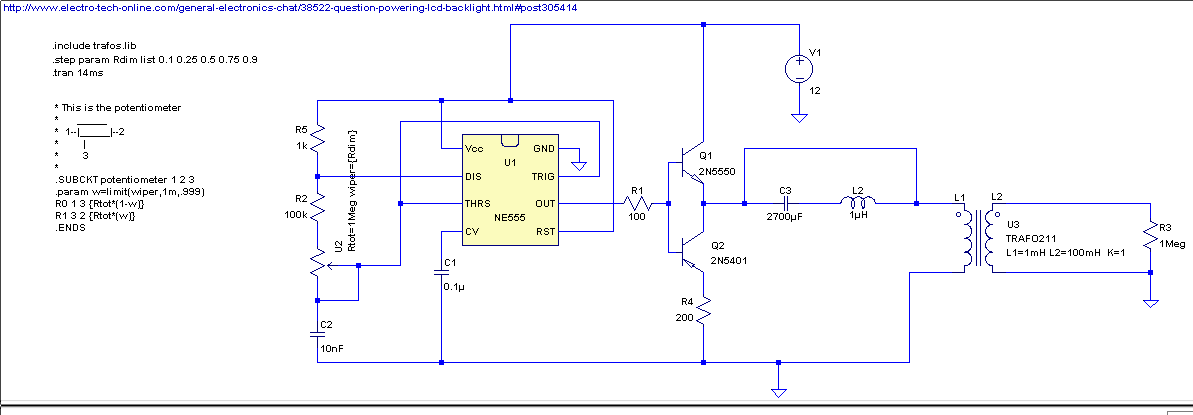

Further to Torbens suggestion that the circuit is overkill, I was wondering if simply putting the output of a 555 astable circuit running at the required frequency through a small audio output type transformer could be possible, again I am thinking this simply because I have some of them to hand, and from the specs on the backlight it seems that very little actual current would be drawn.
It's possible, at least mathematically. There are simple circuits like **broken link removed**. I played around with it for a while in LTSpice and came up with this:
el_driver_ltw-png.18875
Try whatever transistors you can--I'd start with TIP41 and TIP42; I just used the ones listed because I had models for them.
[Edit: just to clarify: that's not my circuit; I just modified Tony van Roon's to do what I wanted.]
Another note: I find that the sim hits around 400Hz output with the pot's wiper at around 0.75 (turned three-quarters up).
Which brings me to one final question - would I need to limit the current to the EL as is required when using LEDs or is the EL somehow self regulating?
Thanks for all the suggestions and help guys, keep it coming please.
Al :)
I don't know the answer to that question. The circuit I posted delivers about 20mA into a 5kOhm load, but I don't know what kind of load the EL presents. The datasheet for the EL panel doesn't show any current limiting on the example schematic, but that doesn't mean that the driver chip used doesn't limit the current.
Torben

Circuit query
Hi Torben,
Just about to start building your circuit when I noticed something iffy. Are C3 and L2 doing anything? There is a link that bypasses them, is this intentional?
I must admit to being a bit lacking in knowledge about inductors so if the bypass is intentional please let me know.
Thanks again.....Al
bigal_scorpio said:
Hi Torben,
Thanks again.....Al
The bypass is just to get the darn thing working in LTSpice. Myself, I'd try it just leaving bypass out to start with. I forgot to mention that in my post--sorry. The cap and inductor are just to try to condition the signal a bit so the transformer isn't getting a square wave (which I *think* would result in an impulse wave output).
Hm. I was thinking I'd get a chance to build this later on but tonight but I forgot my wife's baseball game. :)
Torben
