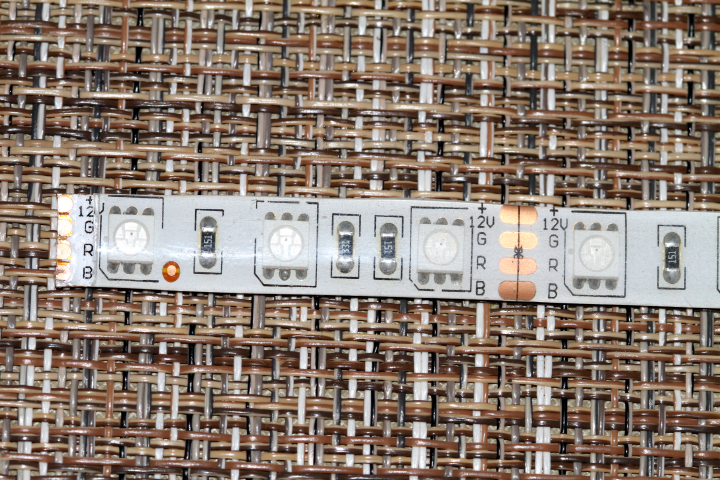

I have a string or strip of 5050 LEDs which look like the below image.
Each small section consist of 3 each 5050 LEDs along with the needed resistors. The strip is designed for 12 VDC operation. This particular configuration is common anode wired. Based on what the thread starter mentioned the LED combination he has in mind is already pre wired for 12 VDC. When deck lighting is mentioned I can only assume multiple LEDs in a single package.

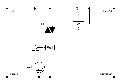

I recently had occasion to look at a 'Radon Fan Warning Light', it was from a local school who were complaining it didn't light up, so they didn't know if the fan was working or not. In the event there was nothing wrong with it, except they didn't understand it's function - it actually lights up if the fan stops drawing power - as it used a SPDT relay I rewired it to work as they wished.
It was a nice simple device, a resistor in series with the load, and a triac connected across it, which triggered the relay. It would work just as well in this application, but obviously with a lower value resistor.
OK, sorry about been a bit late, but we had a 3D printer arrive, and got distracted :D
Here's the schematic of the Radon Fan warning light - reduce R1 for higher currents.
The triac was a BTA06-600T, and the relay an RTE24730.

What value resistor did you use for R1 ? If your load takes 3.4 amps it will need to be much less than 15 ohms. If you used 15 ohms you would be applying 51 volts to the gate which would have destoyed the triac. R1 would be disipating 173 watts.
Les.
Perhaps you should read the posts :D
The 15 ohm resistor was for detecting a fan.
Hi Nigel,
I was assuming that Kevin was using the schematic from post #32 to drive a light but did not reduce the value of R1 to a suitable value as you suggested in post #32
