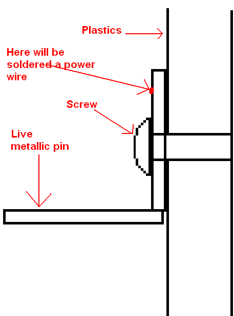

Hey,
In the following configuration, what would be better?
A flat head or A pan had screw?
metals-gif.33310

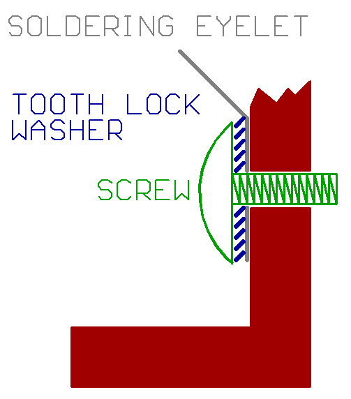

Hi alphacat,
for a connection like illustrated you best use any screw (not lentil shaped), a tooth lock washer and a soldering eyelet.
The tooth lock washer keeps the mechanical construction tight and the soldering eyelet ensures best conductivity.
For extra good conductivity you might also solder the eyelet to the metal.
Sequence of parts is shown in the attached sketch. (Plastic part omitted)
Boncuk
I remember the other thread where you asked about using 16 amps with screws into plastic, and everyone telling you it's not safe as the plasic will "give" and you will get a bad connection and overheating etc. You need non-compressable material to clamp the connection, ie metal screws into metal posts with no squishy plastic in there anywhere.
Now you're telling us not only is it 16 amps, but it is 16 amps AT MAINS VOLTAGE??? :eek:
And you still have screws supported only by plastic!! :(
