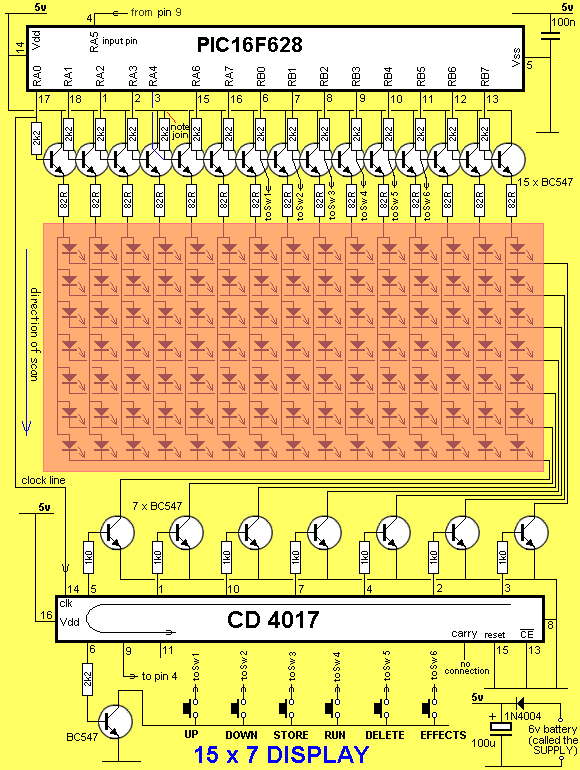

I have completed a free project posted from "Talking Electronics website - http://talkingelectronics.com/projects/15x7Display/15x7Display-1.html". I upgraded the code from 16f84 to 16f628a before the site had updated theirs. The project worked great all buttons worked the way they are programmed to. The orientation as you see below in ATTACHMENT#1, the LEDS are in a setup of Anode Columns and Cathode Rows.
Well I have duplicated this project again using male and female pin headers to attach multiple boards and I want to upgrade the led board to three 5x7 LED Display Modules(datasheet is ATTACHMENT#2 below), LTP-2157AKA. I was in a hurry while ordering from DIGIKEY and didn't pay attention to what I was buying. I ordered a module with Anode Rows and Cathode Columns.
My question is: Can I switch something up to be able to use these modules or order a different set? All help would be awesome.

It can be done, but I don't have time to work it out in detail at the moment.
However, yoiu may have to make some small changes to the PIC programme.
Are you able to do this?
If you were able to change the program, it should be no problem changing the outputs to be inverted, right?
Then you would just need to swap the NPNs for PNPs and swap the +5v and gnd rails going to them. If youre doing this on a breadboard it should be easy to change the rails, on a ready made pcb it might be harder.

I have studied the circuit & I have found it is more complicated than I thought.
The complication is due to the buttons.
I'll need to think about it further to resolve this issue.

Tom,
The type of button is irrelevant to the issue.
The issue is related to the fact that we need to transpose the collectors and emitters of the column driving transistors so they become inverting switches is rather than emitter followers.
However, once we do that, it prevents the button function from operating.
In the attached diagram, I have only altered one of the column driving transistors, one LED and one of the row driving transistors in order to show you the basic idea.
The solution I have thought of is to use MOSFETs (such as the 2N7000) in lieu of the NPN bipolar transistors that are associated with the button function, i.e. those inside the red box on the diagram.
The 7 transistors at the bottom, i.e. the row the drivers, must also be transposed so they become emitter followers rather than inverting switches.
I don't need to see the code since this arrangement means that you will not have to change the programme.
The MOSFETs should be connected such that the sources are connected to ground, the drains are connected to the 82R resistors and the gates to the 1K5 resistors.
You will have to isolate the tracks as shown in the drawing so that the 5 Volt is connected to the collectors of the row driving transistors and ground is connected to the emitters (and the MOSFET sources) of the column drivers.
You should check where the tracks go to ensure that you are not isolating something that should not be
isolated.
If you have any questions, just ask.

If you have plenty of 2N7000's available, then all of the column drivers can be 2N7000 if you wish.
If so, you can use the 2k2 resistors on their gates in lieu of the 1k5 resistors I indicated.
The resistors are much less critical for the MOSFETs than for the bipolars, since the bipolars need sufficient base current to be reliably saturated. (the base current needs to be at least 10% of the collector current).
I estimated that the collector current will be about 28 mA, ie. there will be 28 mA through the LED that is on.

Here is the simplified drawing I mentioned. This should make it easlier to see how it works.
EDIT. I had neglected to include the 82R resistors.
I have now included them in the amended drawing & I have included some notes in green.
If you are intending to make your own PCB, then the green comments show how the circuit can be simplified.
This would be a better option, but it would need significant changes to the programme - or write a new programme.
The programme will be simpler since the buttons logic is much simpler.

I don't know which way the LEDs are scanned, so I'll assume for the purpose of this explanation, that the scan starts at row 1, column 1 then goes to row 1, column 2 ... row 1, column 15, then goes to row 2 column 1, etc.
Note that I have suggested that the column drivers are MOSFETs, but NPN transistors could be used instead if you prefer.
During the initialisation sequence, the PIC sets RA4 briefly in order to reset the 4017.
Then it sets RB1 in order to turn the first NPN transistor on thus addressing row 1.
It then sets RA7 briefly in order to increment the 4017 so that outlet 1 goes high.
This turns the first MOSFET on thus addressing column 1 - hence turning the first LED is on.
The Up button is connected to RB1, the Down button to RB2, etc.
So if the Up button is pressed while RB1 is set, RB0 goes high thus alerting the PIC that the Up button is pressed so it can perform the appropriate function.
At the end of the scan period, RA7 is set briefly in order to increment the 4017 so the outlet 2 goes high.
This addresses column 2 hence turning the second LED is on.
This process continues until column 15 is addressed.
At the end of this scan period, the PIC sets RA4 high briefly in order to reset the 4017.
It then clears RB1 and sets RB2 to address row 2 and then sets RA7 briefly in order to increment the 4017 so that outlet 1 goes high to address column 1.
If the Down button is pressed, RB0 goes high thus alerting the PIC that the Down button is pressed so it can perform the appropriate function.
Here is another option, this one eliminates many of the discrete components by using two integrated circuits.
However, it requires some programme changes.
Description
During the initialisation sequence, the PIC sets RA to 10-- -001 & clears RB (- = don't care).
This makes U1 output 1 low thus activating Column 1.
Then the PIC sets RB1 which turns the first NPN transistor on thus activating row 1 - hence turning the first LED is on.
At the end of this scan period, RA0 is cleared & RA1 is set thus U1/1 goes high & U1/2 low.
This activates column 2 hence turning the second LED is on.
The RA2:0 outputs are changed at the end of each scan period in a binary sequence so Columns 3 ~ 7 are activated in turn.
At the end of the seventh scan period, RA2:0 are cleared, RA6 is set & RA7 is cleared.
This activated Column 8.
As before, RA2:0 are changed at the end of each scan period in a binary sequence so Columns 9 ~ 15 are activated in turn.
At the end of the 15th scan period, RA is again set to 10-- -001, RB7 is set & RB6 is cleared.
This reactivates Column 1. RB1 is cleared & RB2 is set thus activating row 2.
This process continues until all LEDs have been addressed & then the first LED is re-addressed as described above.

I very much like this the best.
I ordered some 74ls145's from NTE and waiting for them....in the meantime I'm gonna try and see if cd4028 will work.

Don't bother trying a CD4028.
It has 2 problems:-
1. It has Active High outputs (you need Active Low)
2. It cannot source or sink the current you need.
