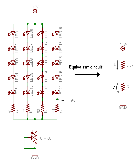

quick simple schematic check, please...
oh, i see. so... like this?
i wasn't sure whether to put the pot before or after the 15ohm resistor (or if that even matters). just saying.
Now when the pot increases the current then all or most of the LEDs will burn out.
Each string must have its own current limiting resistor.

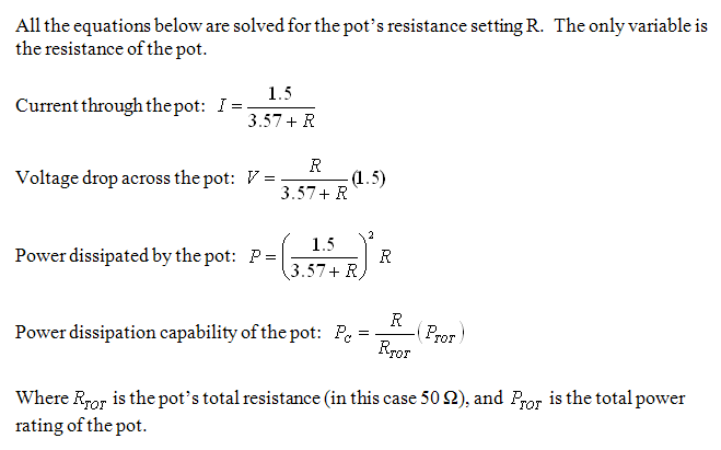

To help me understand the problems with using a pot the way I proposed, I came up with some equations and graphed the results. If I’ve made any errors in any of the steps please let me know. Here’s what I did.
I took the OP’s circuit and replaced it with an equivalent circuit just to make the analysis easier:
Then I wrote the equations for current through the circuit, voltage drop across the pot, power dissipated by the pot, and lastly the power dissipation capability of the pot all with respect to its resistance setting.
From an earlier post I got the impression that the power dissipation capability was linearly proportional to the resistance setting. When the pot is at its full resistance, the power dissipation capability is whatever it’s rated for, when it is at or near zero resistance, its power dissipation capability is at or near zero. Here are the equations:

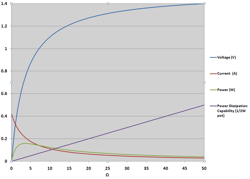

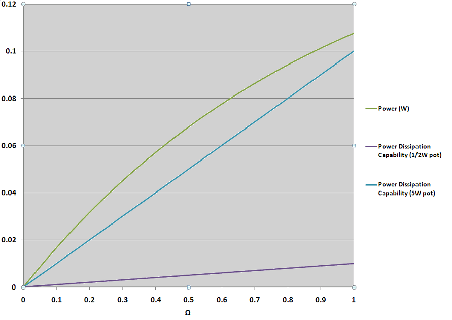

Next, I plugged the equations into an excel spreadsheet so I could see what was going on. In viewing the graphs the power dissipated by the pot never even gets up to 200 mW but there is a region from about 0 - 11Ω where the pot is set to low resistance that the power being dissipated exceeds its power dissipation capability. That I assume is what adiouguru referring to.
I can see this now and it makes sense. This region exists because the power dissipation capability increases linearly while the power being dissipated increases exponentially. As a result, there will always be a region where the pot resistance setting is low that you have insufficient power dissipation capability.
The higher the power rating of the pot and the lower the initial current, the smaller that region will be but it will always be there. Here is another graph with a line corresponding to the power dissipation capability of a 1/2W pot and one for a 5W pot. It's zoomed in to show the effect but even with the 5W pot the region still exists.
And, if I understand all this correctly, that region will exist anytime you use a pot regardless of the specific circuit, voltages, or currents involved.

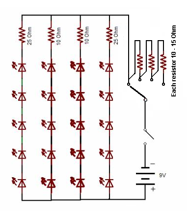

If you're dead set on using a POT, or at least something like it, use a rotary switch to switch several banks of LEDs, it's simple it's efficient and it only requires you to find a rotary switch that can conduct the current required, which isn't very high.

Personally I think continuously variable brightness on a lantern is dumb, I would prefer 2 or 3 brightness settings, maybe implemented as a 4 position rotary switch;
off - low - med - high.

Using a rotary switch is a simple solution if you are OK with not having continuos brightness adjustment which it sounds like you are. Here is an example of a switch that would work for you. Click on the link to the data sheet for information on which pins correspond to which positions. It has 4 posititions so you will have 4 brightness levels. You can select a switch with more positions if you want additional brightness levels. The attached schematic shows one way you can wire up resistors to adjust the brightness. You don't need the 317. That was just when you were going to use it as an adjustable current source.
