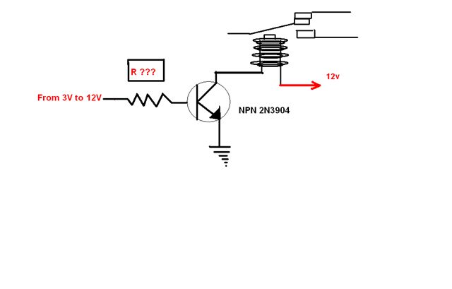

I am using a NPN transistor 2N3904 to triguer a small relay
This is what I have: Emiter is conected to ground, Collector is the negative output that will triguer the relay and what I need to find is a value of R that I can use on the Base in order that it will work "FROM" +3V to +12V
At the present time I am using a R of 1K and its work perfectly with +12V but when the voltage decay to +3V it does not work.
I know I have to lower the R but my concern is if I lower it to much in order to work with 3V maybe when ir receive 12V its going to blow the transistor.
What is your advise? What R value you recomend me?
THX,
Malibu

The relay has a contant +12V at one end of the coil the other end of the coil is the one I want to triguer with 0V that the Collector will output. (NPN 2N3904 Transistor )
What I need is to triguer the transistor base with a voltage from +3V to +12V so I need to put a R to limit the current to the Base of the Transistor in order to not blow the transistor. What R value I can use????
The factory system that I am interfasing is working with +3.6V and +12V thats why I need to triguer the base of the transistor with those voltages.
THX for your help,
Use 3.3k for your base drive resistor. It will work with 3v or 12v drive, and won't damage the 2N3904. If the 12v source can't drive the 3.5ma load, that's another issue.

You said the relay was 12v, 200mw. 200mw/12v=16.7ma. That should require less than a milliamp of base drive. Either your 3v source impedance is really high, or your transistor is bad. What sort of device does the 3v logic level come from?

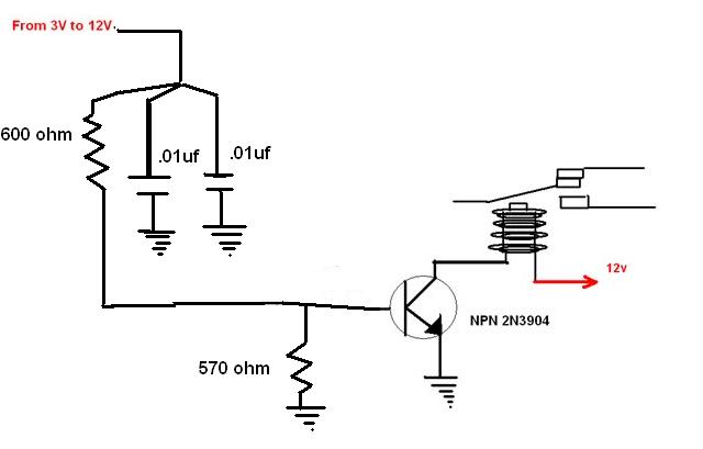

Ok, let do the following. Forget about the relay. lets asume I want to drive the base of the 2N3904 with 3 to 12V. and the emitter is to ground.
What is the lower resistance I can use?
Some body recomend me to do this:

TBoss, what you're trying to design is called a transistor switch, in which the transistor is operated between saturation and cut off. This is usually done using known fixed voltages, but it appears you've thrown a curve ball with a circuit design that requires a variable base drive voltage.
What you have to do is design for the lowest drive voltage which will allow for saturation and at the same time protect the transistor from accessive base current ( when the input rises to 12 volts )which could destroy the transistor. The best way i can see to do this is to connect a zener diode between the base and ground, so the zener will be acting as a voltage regulator.
A suggestion :
Use a 450 ohm resistor in series with the base, connect a 4.7K resistor from the base to ground and put a 5 volt zener in parallel with the 4.7K
Turbo Boss, you led me astray with your "200mw" statement. Now you say it's 200 ohms. If you expect good advice, you must be careful to answer questions accurately. A 200 ohm load will draw 60ma, so we should probably have at least 3ma of base drive (conventional wisdom would require 6ma, but we'll fudge a little). So, for 3v drive, we'll have about 2.3v across the resistor (the base-emitter voltage is about 0.7v). The base resistor will then need to be 2.3/3ma=767 ohms. We can use 750 ohms, but now we will get about 15ma of base drive with a 12v input. This may be too much drive for a 2N3904, but worse, it's probably too much current to draw from your 12v driver. If not, use 750 ohms.

Nettron, your zener idea won't work. The base voltage will never get above around 1v, because the base-emitter is a diode to ground. You must be thinking of a MOSFET. In fact, a MOSFET might be the best solution if there is one available with low on resistance at 3v base drive.
