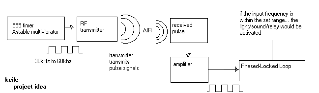

we have a design project at school and this one is what we proposed: "E-Wi Fast Finder".
here I attached a block diagram of my proposed project.
a 555 timer configured as astable multivibrator will generate a pulse. Pulse can be measured at the output of the timer. I want to connect this output to the input of a RF transmitter then transmit the pulse on the air. The problem is I don't know what kind of transmitter should I use... I just want to send the pulse into the air!
any help would be appreciated! thanks in advance.

just a quick question...how far does it have to transmit??
There are lots of options already such as
-building your own circuit from scratch
-Prebuilt units
-hacking it out of something eg. a remote control car
-Infrared
so yeah its your choice, i would go for infrared for something for something short range (and line of sight)
Pike
hello! thanks for the reply :)
the distance would be at least 10m
it will use radio waves since it needs to find things
i have been searching for at least prebuilt or already existing circuit but I can't find any exact circuit and I don't know how to modify existing one. So I have to start from scratch with some idea looking at similar projects.
