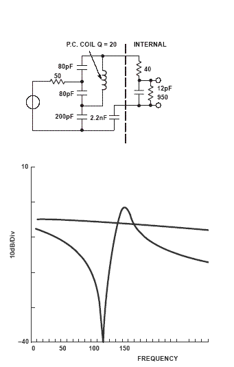

I found an application note that gives the input model of the TDA7000 and worked from there. My plot seem to agree with the one in the application note.
