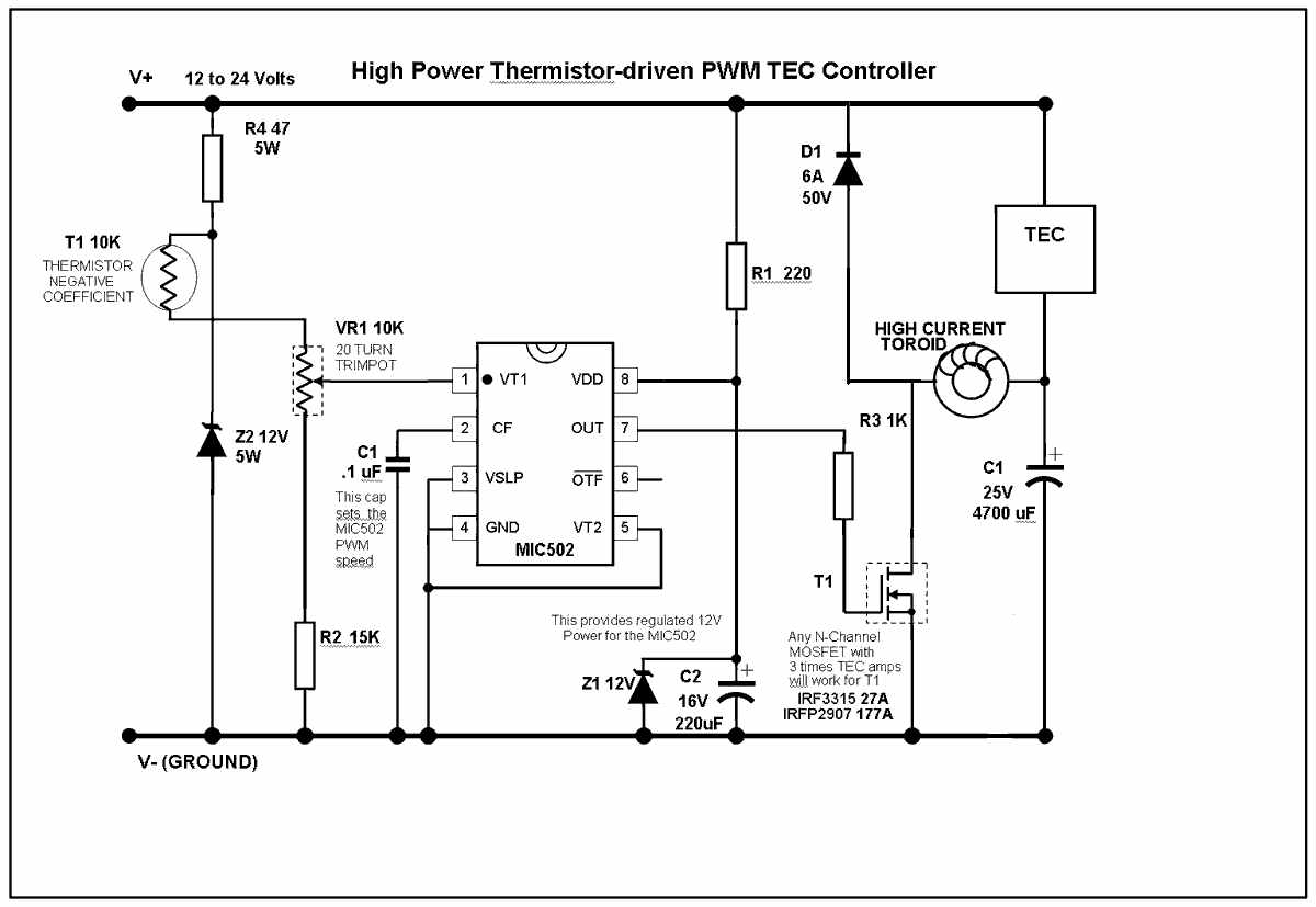

I want to drive a couple of 12 Volt peltier devices. Maybe 30 or 60 watts and I want to ramp down the DC power to the peltiers on shutdown over a period of around 5 minutes or so to zero volts / amps. The ramping time period is not terribly important. I just want the cooling fan on the peltier to be able to draw the residual heat off so it doesn’t slam back into the thing I just cooled. So I’m guessing 5 minutes ought to be OK. Maybe 10? I have not purchased the peltiers yet so I have no empirical data.
I have learned that I can use a switching PS like an ATX unit to drive the peltiers so long as there are no other loads matching one PS to one Peltier.
I also don’t know whether it’d be more straight forward to build a ramping device for each peltier or for a group of them. Prolly one each would be smartest, I’m thinking.
Any help? Know of any circuit designs that will do what I am looking to accomplish?
The simpler the circuit the easier for me to breadboard it together.
Elegance is not my goal.

I believe that PWM technology is the most likely candidate but ya know this is the internet-S and my being able to say the words "PWM technology" doesn't serve to make me any more informed about it.
I've looked at PWM modules power supplies and peltier cold plates from on manufacturer. They sell individual configurable modules not turn key systems and even in that format they are more $$ than I want to throw at it. Driving a lousy 30 watt peltier ends up costing me about $600. I'd just buy the PWM module but they made it to only run on goofy voltage so on can't just use any peltier or power supply.

This circuit has been used successfully by several people. It will ramp down the voltage to the TECs as they get colder.
You can use a different NTC thermister if the one suggested does get the result you want -just alter the resisters in the bridge to suit.
It has been tested for voltages between 12v and 24v - you need at least 12v to run the MIC502.
I am sure the experts on here could possibly even suggest alterations to it.
