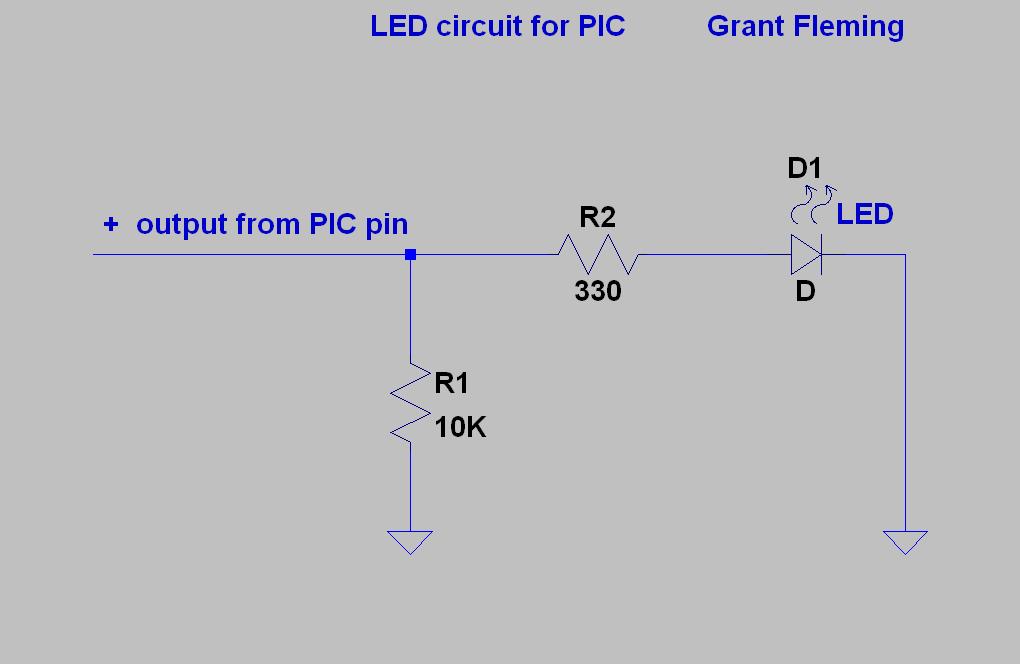

Here is an attachment of an LED circuit for a PIC.
Cheers,
Grant

justDIY said:
what is the purpose of the 10k resistor ... it looks like a pull-down, but isn't the LED a good enough pull-down by itself?
Don't see any reason for it at all?, just the LED and series resistor are all that's required.
OK...OK guys!
I have required pull-down resistors for many projects I have made lately and just threw it in, i agree, no need to use it- get over it!
Point taken, thanks.

Grant Fleming said:
Thought you might have been happy and chosen something more positive to say, eg; about me having the resistor on the anode of the LED for thermal reasons!!
Is it because the cathode of an LED is mounted on one pin and has good thermal conductivity to the copper on a pcb but the anode has just a thin bonding wire that cannot conduct much heat from the resistor?
Clever you!
