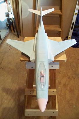

I am interested in making a small, lightweight noise generator, amp, speaker circuit for a radio-controlled jet. I am hoping to use some of the components from those musical greeting cards if possible.
Does anyone know how to do this? I am a complete newbee to this stuff but am a fast learner with some help.
The plane will carry an 11.1v battery or the device could have an independent power supply if light enough. Here is a photo of the "jet" almost complete.
Any help would be much appreciated.
FMD.

The sound of a turbine is pretty distinctive, you'd need variable mixed tone generator that was coupled to the throttle, or people would know it's a fake sound right off the bat unless you were flying with a fixed throttle over a long distance, the eye/ear wouldn't match from people's experience. That'd be a bit of a project to bite off if you don't have a clue as to what you're doing.
Simply playing back a fixed sound over a speaker is not gonna work, especially considering how loud you need it to be at a distance to even know it's there, it'd be a relatively decent amount of the power from your battery pack.
Yep, getting the volume loud enough is going to be the killer. I guess the speaker has to be enclosed in the body/wings and will only have small holes for the sound to exit but then you will have 20 MPH (30 MPH?) air basting over that surface at a 90' angle.

The "jet" is powered by a small pusher prop on a brushless motor mounted on rubber bushings... pretty quiet.
The speaker will be housed within the fuselage but instead of holes to allow sound to pass I was thinking of a taut plastic film over the speaker housing. May even amplify a bit like an acoustic guitar.
As far as the characteristic sound of a real turbine that would be ideal but to sample that and utilize would require a loop... not feasible. So, make a jet sound when you play with your kids. Bet it sounds like static noise that trails off as you run out of breath. The key is the doppler effect as the plane goes by.

FMD, did you not read any of the posts made? You can generate a little noise using a recorder and play it back on a cheap speaker, but to get something that you will hear at a distance when the plane is running will probably require more power than all of your servo's combined. You could try a monoblock amplifier (Google it) and a decent power speaker, but the speaker is likley to weight almost as much as half the plane and throw it's performance right out the window. Basically what you want to do is not practically possible.
I read the posts. Believe me this will work and is not without precedent. It is amazing how well sound carries especially if you fly in a dead calm. I could take the greeting card tape it to the plane right now (if it was light outside) and hear Kool and the Gang playing Celebration from 200 feet away. Not quite the effect I am looking for but you get the point. That is running off of a couple of coin batteries.
