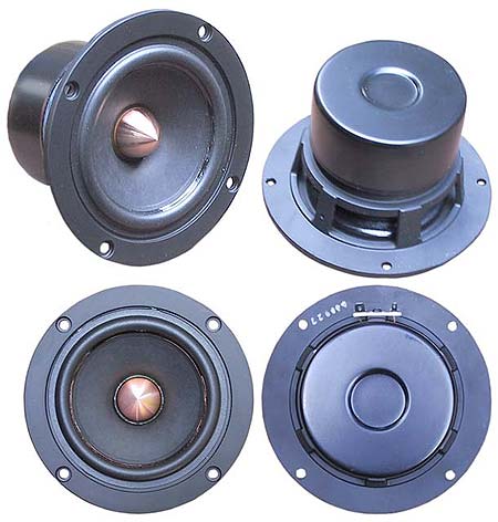

A real big magnetic speaker produces most frequencies, not just the little high frequency squeaks from a piezo transducer.
On the internet there are many recordings of jet aircraft sounds. They sound real when heard on my pc magnetic speakers but will sound like little squeaks on piezo squeakers.
How 'bout a 40-50mm magnetic speaker. They weigh in around 40 grams and are really inexpensive.
A 2" inexpensive magnetic speaker is garbage. A 4" fairly expensive heavy speaker is beginning to sound good.
My little pc speakers sound pretty good. They are 3" and have huge and heavy magnets. Their enclosures are pretty big. The speakers look like this:
Then we would run into weight problems both with the speakers and the amplifier. I still think the doppler effect is the key with a lightweight low power system. Earlier I posted about the sound effects kids make (or adults for that matter) for a jet. I dunno, kinda sounds like static to me. There is a way to make a noise producing circuit with a small speaker. Granted it won't have the low frequency rumblings of a real jet, but a close pass even in a glide will sound pretty good to a kid as the jet passes by.
