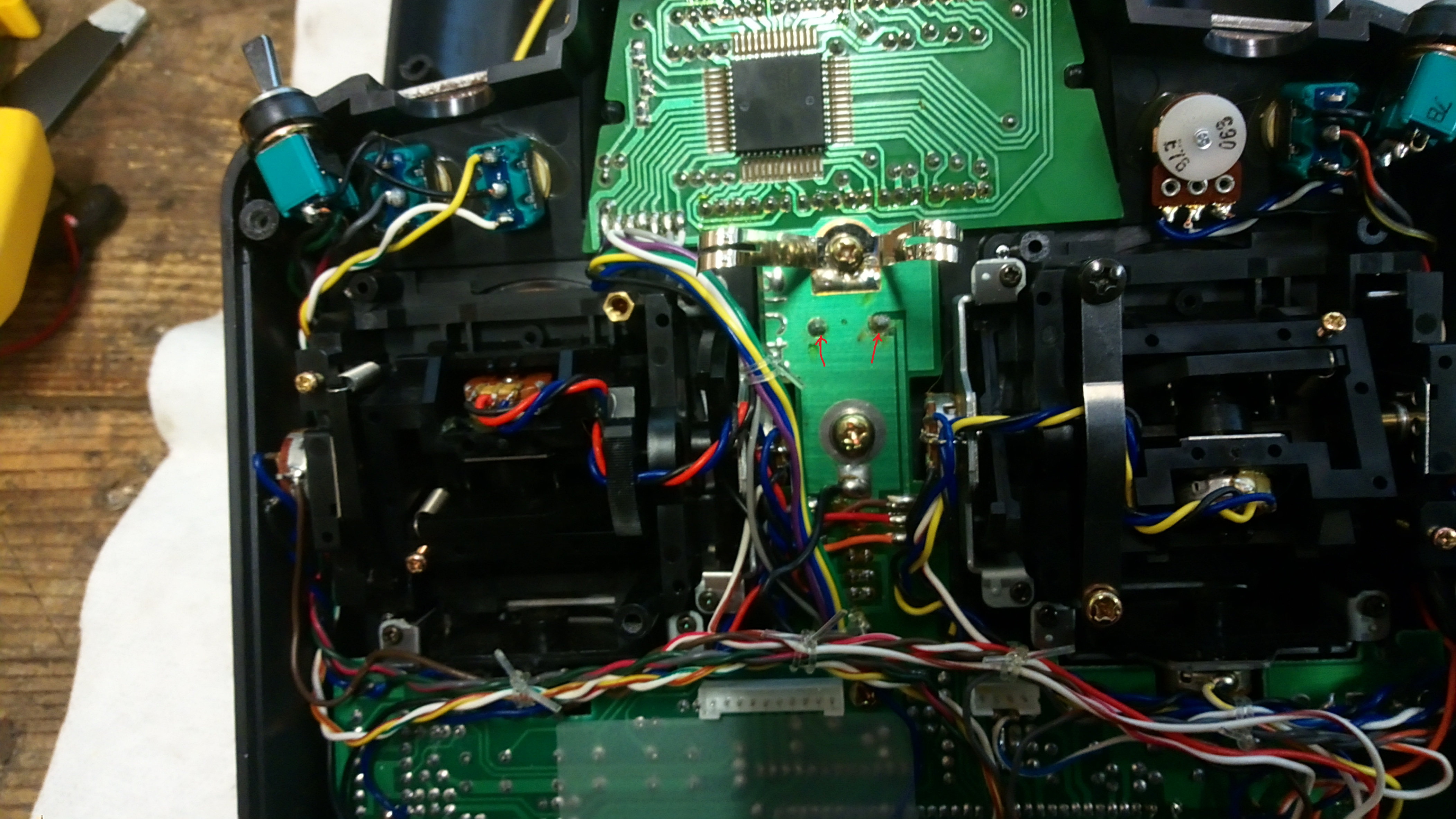

This is the first time I have ever used a forum for anything so please bear with me if I'm wrong. To give a little background I'm a long time model aircraft builder/flyer and I'm having difficulty at the moment as my hearing is failing and I find it impossible to hear the countdown timer on my transmitter this is a small sounder built in that you can set for any time duration this bleeps at 1 minute and then counts down the last 10 seconds. My question is can I make a vibration device to retro fit so I can feel the timer though the body of the transmitter similar to a mobile phone. Can it be simply connected to the buzzer output. Does anyone have any experience of such a device and how to make and fit please.

Sorry for taking my time had to attend a breakdown/repair on my car. Anyway I have taken the back off the transmitter and exposed the terminals to the sounder (see picture) I have removed this board and on the other side is a standard looking black circular sounder. Whats strange to me is the voltage across these terminals is the same as the battery voltage ie 10.5v but when I trigger the timer it seems to drop when it beeps its difficult to tell by how much as it is quite rapid. I was expecting to get 0v and and a voltage when it beeps any idea why this is.

We do not know if the sounder is a speaker with a coil or of it is a piezo transducer that does not conduct DC and is fed an AC signal.
I don't think it's ac as I tried ac setting on my multi meter and got no reading. But did as described on dc, if that's any help
A speaker with a coil conducts DC then both terminals will have the same DC voltage.
A piezo speaker does not conduct DC so its terminals might have different voltages and it is fed a few volts of AC to beep.
Maybe it is a piezo buzzer that has an oscillator inside that is powered from DC.
If there is a part number then only the manufacurer will know its details.
Most of us would connect an oscilloscope to it to show what drives it.
