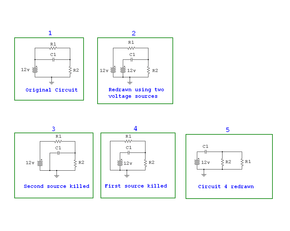

We are not forced to use superposition, but for the question of how R1 gets in parallel
with R2 to form the time constant R*C1 can be visualized a little easier when looking
at what happens when we do use superposition. See the attached drawing for a
graphical view on this and note the last circuit how R1 and R2 ended up in parallel.
You can use superposition for any circuit like this really. It's a more general principle
that pertains to linear circuits.
Here's the drawing:

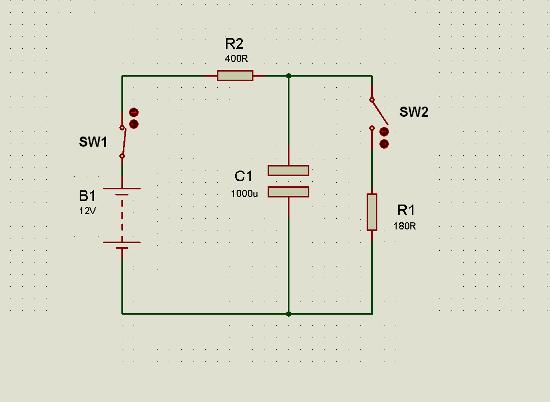

Ok, concerning to the simple flasher circuit which I have put its schematic here,
My relay turns on when the voltage across it reaches to 9V and turns off when the voltage drops to 3V. I want to solve it and find the time constant for charging and discharging proses with this asumation that my 400R coil is a pure resistor with turn on voltage of 9V and turn off voltage of 3V, so I can use this formula "t=-RC*ln((Vc-Vs)/Vs)
" for charging proses and time constant at 9V and the other formulas and your explanations for discharge proses, right.
What's your idea of how much of deviance I will get in reality? it's no matter though because I wanted to learn the BASIC principles behind the circuit, and I could by your help.

I am uploading a new schematic with the components moved around slightly so
that one end of the cap is grounded. This will make it easier to understand as
well as talk about. Take a look at this new schematic before you read the
rest of this as all of this pertains to that new schematic.
Starting with the initial cap voltage Vc0=0 when switch SW1 is closed the
cap charges like this:
Vc=Vs*(1-e^(-t/RC))
(where Vs is the full source voltage 12v here)
and that is rather simple because there is no cap voltage to start with.
When there is a cap voltage to start with the exponential still looks the same
but it's amplitude is different. In order to take into account the initial cap voltage
we first have to subtract that from the source voltage Vs first, but then
later add it back again. This modifies the formula a little:
Vc=(Vs-Vc0)*(1-e^(-t/RC))+Vc0
Note above that we simply first subtract Vc0 from Vs, multiply that result times
(1-e^(-t/RC)), and then finally add Vc0 back to that result to get the final value
of Vc at time t.
Take a second to note the 'magic' formula "1-e^(-t/RC)" as that is the basic
charging pattern for caps and resistors. The cap charging wave always follows
that basic pattern.
Let me know what you think about all this and we will eventually get to the
discharging part of the problem again. Right now lets concentrate on the
charging with or without an initial cap voltage Vc0 ok?
The new schematic:

Really sorry but I have another question regarding to our circuit which you calculated it's parameters:
Suppose I am starting to design the circuit, At firs I look at what parameters I currently have,
I have relay's voltages in 2 process (1- voltage which makes my 12V relay on and causes the contacts to stick together Which I can found it by tuning my regulated power supply (it was 6V for my relay). 2- The voltage of the relay when I want it's sticked contacts to be freed which was almost 3V for mine). So I have my Cap voltage in the formula Vc=Vs*(1-e^(-t/RC)) and so can calculate the TIME parameter (i.e "t") for my circuit and in opposite side if I want to decide of the time by myself then I can put the decided "t" to the formula and calculate the cap voltage, right.
Now consider when that I am trying to design the circuit by myself, Then I have to undefined parameters, R and C?! So I have 2 undefined parameters then How can I calculate and find one of parameters "Vc" and or "t" while R and C are undefined????! If you know what I mean?
Sorry for a lot of questions, But I am learning and need to know, besides, Actually this is a simple circuit and so I am able to understand your meanings more easily than more complicated circuits and this helps me to be able to analyze them easily in future.
The other question is how to determine the MAX power draw of 180 ohms resistor to choice a suitable one?
Thanks before hands.
