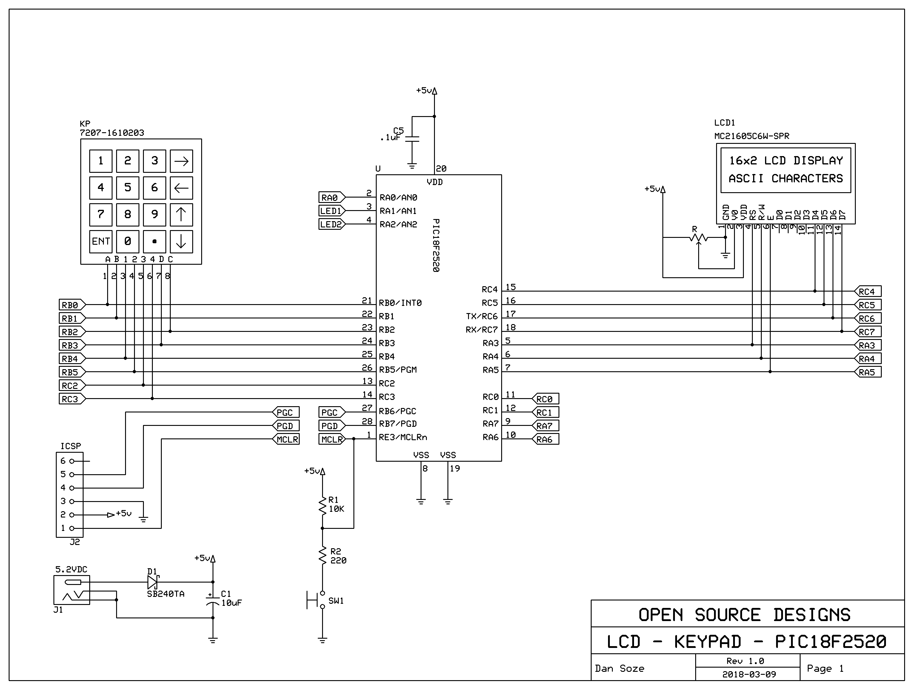

I pointed out to MrDEB that he can't have the PICkit 2 connected to the ICSP connector while he's trying to read the keypad. MrDEB, completely ignoring that comment, replied "I have it connected during testing." Once again, MrDEB has decided that the world works in a special way for him, and the PICkit can't be connected while you are using the keypad doesn't apply to this case because it's not convenient.

As I have explained numerous times, the keypad module takes care of all the details. If you are using port B, you don't need pullup resistors; the built-in ones will work fine as evidenced by my working code 160 messages ago. If you'd rather use a different port for God knows what reason, then you need pullup resistors AND you need to specify the correct port for the keypad module.
Connect the keypad, add less than 5 lines to your code and it will work.

The attached files are my schematic and the port to Swordfish BASIC done the the truly excellent tumbleweed.
This code works in this real hardware:

Hi Dan,
Nice design. Have you considered one of the newer 18 series chips such as the 18F24K40. The newer chip has WPUs on all pins so you can move the keypad and LCD onto ports A and C and leave the ICSP connected.
I wondered on price so checked at Microchip - 18F2520 is $3.18 - 18F24K40 is $0.87. And, for another 7c you can increase the memory from 32k to 64k (25K40).
P.S. Don't know if Swordfish supports it.
Edit, Sorry Dan. Just noticed you haven't used the ICSP pins.

Bert, the keypad module allows you to specify which port to use. You would only have to add which chips support pullups on other than port B.
