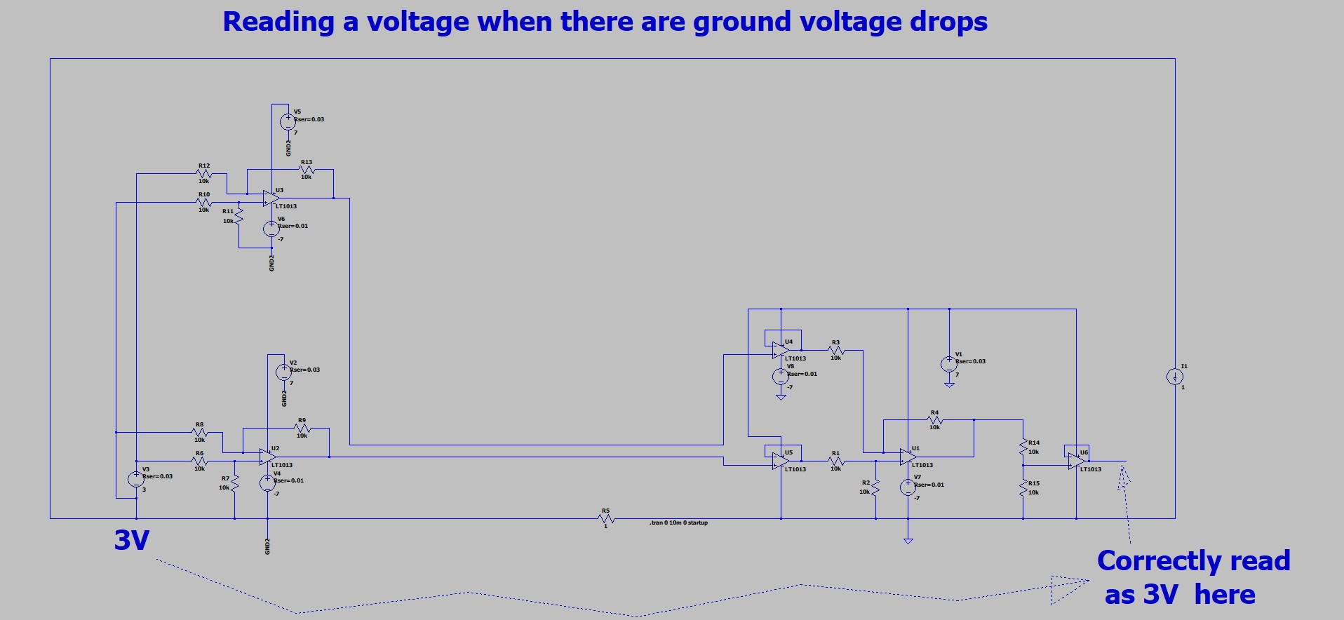

Reading a voltage when there are ground drops?
Flyback
Do you know of a lower component count solution for the following?...
As you can see, there is a Diff Amp which reads a 3V source voltage…..then passes it to circuitry which is grounded to a slightly different potential….and that circuitry there must read the 3V voltage correctly.
The attached does it but is too high in component count. Do you know of a lower component count way?
  • Diff Amp for when there are ground drops.asc
Is there a reason why you felt that a simple, single stage diff amp would't work?
That's what I've modeled in the attached circuit.
Note: I've also change the 3V source to be a 200mV saw tooth centered about 3V, and ramped the current to see that it works over varying conditions.

Are you planning on using an A/D to read the voltage ?
If so many now available with differential input stage, including processors
with onchip A/D's.
What is the accuracy, resolution you want for the measurement ? Diff stages
built out of discrete OpAmps and resistors have issues in resistor accuracy
affecting common mode rejection. Instrumentation Amplifiers solve that
using laser trimmed diff amps that are done during production.
Regards, Dana.

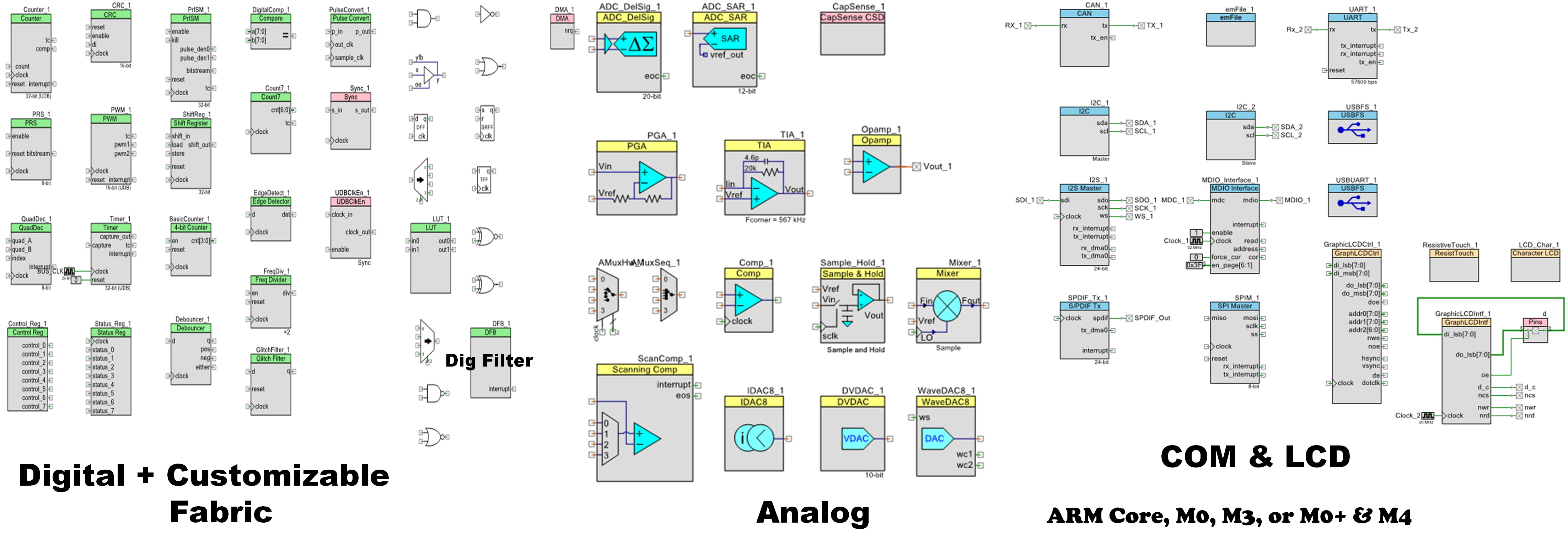

Another method, single chip :
This can be done I think w/o CPU intervention as well. Also most chip resources
available for other tasks.....see right hand window resources used/left.

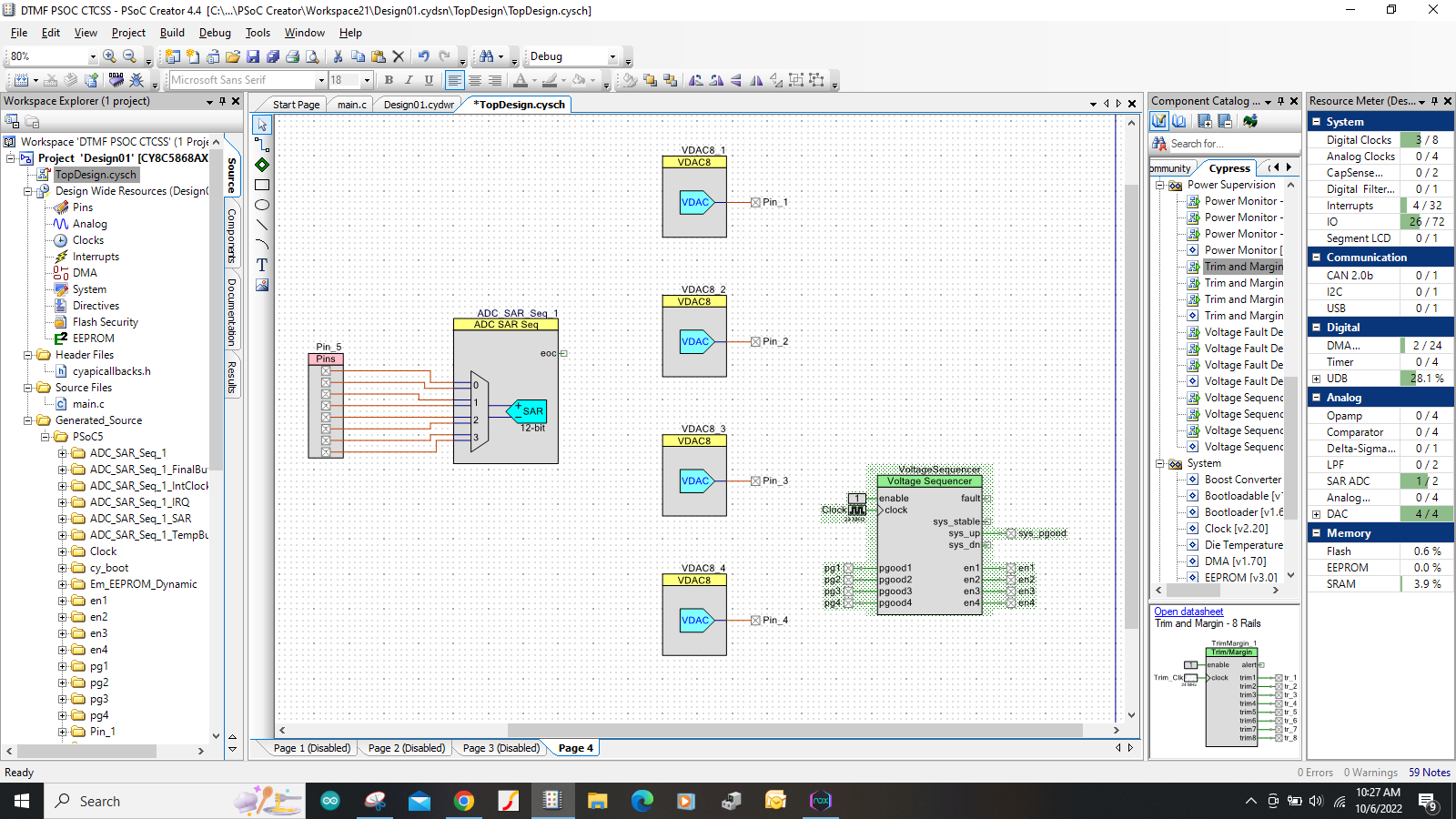

Whats on this chip, multiple copies in many cases :
If you use the onchip DelSig and Analog Mux facilities you can configure the effective gain
as seen by the ADC.
If the DAC range, 0 - 4V not exact fit you can use the onchip OpAmps in PGA configuration
to scale that as well.
Note I added sequencer in case you need to have controlled startup of various supplies, thats
also onchip.
Regards, Dana.

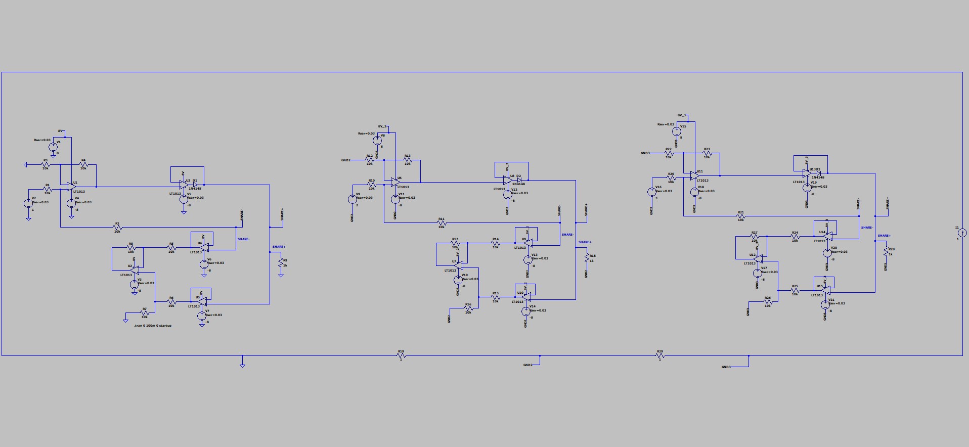

A-ha, Thankyou RJenkins, you were correct, the UC3902 diff amp method does actually work...when i tried it before, i stupidly didnt have the opamp power rails high enough in voltage and i was thus getting saturation of signal near the rails......so the attached shows the differential share bus being correctly received by all three positions.......i am a little concerned though, that , as RJenkins kindly says, the negative of the diff share bus is not actually driven...its floaty......i prefer a driven bus line , since its better for noise immunity.
It does not float! Read the data sheet.
It is supposed to have a single-point ground / 0V connection somewhere in the system. That minimises current on it, so minimises any differences in reference voltage along it.
If you drive it at each point, that's where you can introduce errors.
Neither do you need "ideal diodes" as you mentioned earlier - it's a form of precision rectifier circuit, where the opamp compensates for diode drop, as its feedback is taken after the diode. Just normal signal diodes.
You circuit is still crazy; you only need two opamps in each unit!!!

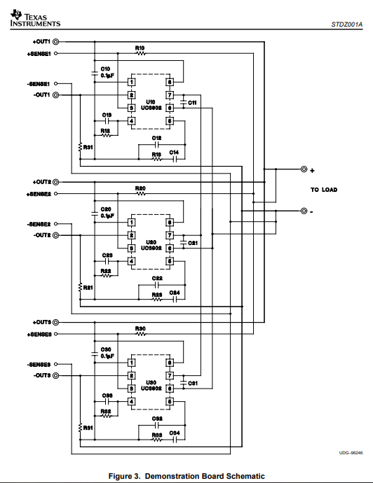

You do not appear to have the ground point on share-
It must connect to some system ground at a single point, as already stated.
The share bus is pulled down to local ground by a 1k resistor at each linear regulator, which i thought was enough?
Thanks, "Share+" is x volts above "share-"......where x is the voltage at the output of the current sense amplifier of the stage thats shipping the most current.....i see what you mean though...on page 9
of the App note the share- is indeed connected to output gnd in one place...
I am not sure why it has to be so?..........After all, as long as you can put the currnt sense max voltage on the share bus, and then get it back off again, then i dont see why it has to have the single point ground connection?
UC3902 App note.
