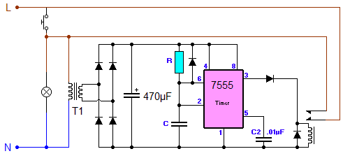

The 555 circuit would work.
Just wire the 555 so it turns on when the power is applied and the relay turns it off the power to the transformer when the delay expires.
T1 is a mains transformer with about output voltage between 6V and 9V.
C is a tantalum capacitor.
If C = 47:mu:F and R = 33M the delay will be about 28 miniutes but in practise it'll be longer due to the leakage current.
You could easilly replace the transformer, rectifier and filter capacitor with a wall plug.

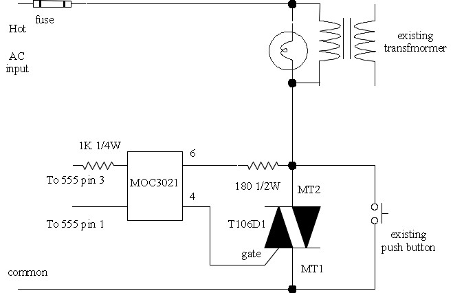

If you did not want to use a relay as in hero999 circuit, you could use a triac and a triac driver such as a MOC3021.
Thanks a lot for the schematic. It will definitely do the job. What I like in particular, is that the circuit does not draw any current when in off position. I will try to build it.
As far as substituting the relay with a triac, I am not sure how would that work, as the relay contacts are in parallel to the push button - this configuration allows the 555 to be supplied after the push button is released. If you have a particular configuration in mind, I'd like to see it.

Here is a suggestion.

I can combine both circuits now. One question: I am not sure I understand why does one need the opto-coupler - can't the triac be driven directly?
Also, since we now have a triac, is it possible to make the light to go out gradually as opposed to switching off immediately?
Generally you should always put the switch in series with the live (hot) conductor for safety reasons, however as this switch isn't supposed to fulfil a safety critical role it doesn't matter.
