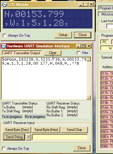

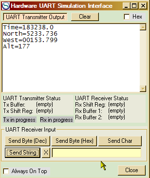

hi Paul,
This is a simple way to extract parts of a string, if you have the maths option with Oshonsoft use PROC /FUNCTION.
At the end of a NEMA string there is a CRLF string 0x0d , 0x10.
Use the CRLF terminator to end the Array loading.
I used copy and paste to enter the $ string into the Oshonsoft hardware UART window,
The UART transmit mode is just to verify the string in testing.
Eric
  • paul1.bas

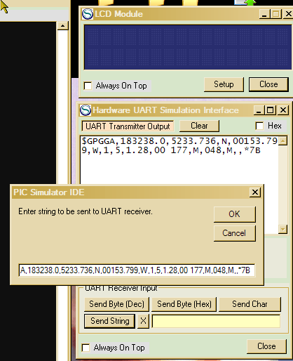

hi Paul,
This option is tidier, I use the UART as an output display.
Copy and paste the GPS string located at the top of the Basic listing, into the Oshonsoft UART for testing.
Eric
  • paul3.bas
