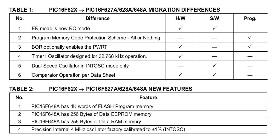

I read from the Microchip website that the 16F628 has one 8-bit and two 16-bit timers, while the 628A has two 8-bit and one 16-bit timers.
16 Family product chart
However, I looked very carefully at their datasheet but could not found any difference on description on Timer 0,1 & 2.
So, what is the real difference between these two chips?

The difference is pretty small:
Thanks Jay. Is the table you have posted hidding somewhere in the datasheet?
So Microchip site wrong about the timers?
There is a Special Migration Data Datasheet, Search Microchip for 40048a. And yes, If they say what you wrote then they are wrong... Everything is in that Datasheet. 8)

Basically the 628A is just a later silicon revision of the 628, as the 84A was of the 84. Unlike the 877A (which is FLASH) the 628A is still an EEPROM device, as the Migration document shows, the differences are very slight.
Hi Nigel please clicks the link I posted earlier which takes you to the Microchip website.
On there it said 628 & 628A are standard flash device. They are wrong about Timers on these chips. Wrong again?
