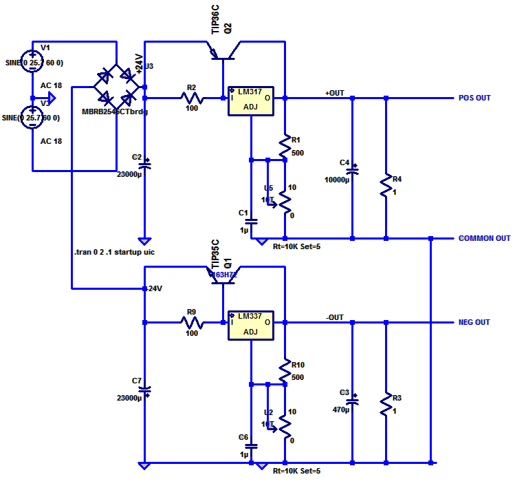

Here's my finished design, seems to be working very well, but I haven't had it finished long enough to make possible mistakes that could damage it yet. Very simple to build, if you have the heat sink and drill and tap to mount the components, started with 20 amp, 13.6v powers supply and made it into a + and - 20 volt supply that can handle a combined 10 amps with out getting a ripple on the out put.

Well are you saying that you will always have a load of 1 ohm at the output?
Because of the extra pass transistor you should still check the current out of the LM317. If there is less than 10ma it may not work right at low voltages, less than 5ma is even worse although many LM317's do work with only 5ma output.
NO, I just forgot to remove it from my spice file before I copied it and posted it. I'm well aware of every ones concerns about lightly loading the LM317 & LM337, so I will be watching it closely to see if it causes any problems. Later to day I'll hook up my Fluke to the output, set it to 3 volts and have it record min max for an hour or so. got any suggestions?
The LM317 should ALWAYS have a load of 10mA because if you need to replace it the replacement might NEED 10mA even if the one you are using now doesn't need this as its load.
The resistor from the output to the ADJ pin should be 120 ohms for an LM317 and can be 240 ohms for a more expensive LM117. Then this resistor with 10.4mA in it stays cool even if the output voltage is increased. Of course the voltage setting pot must have its value work with the 120 ohm resistor.
