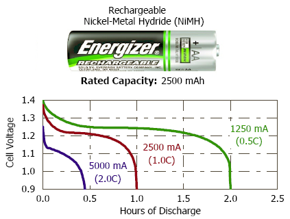

Ni-MH cells are used at very high currents and the capacity doesn't drop.
Here is an AA Ni-MH cell from Energizer:
