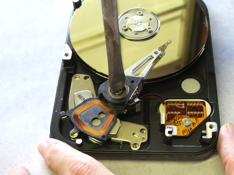

Wikipedia even has an image of such a motor
That's the same principle as the hard drive actuator system, extended. It is not a solenoid actuator in the conventional sense.

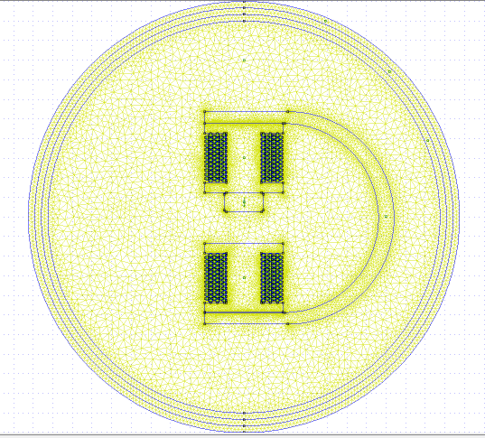

Funny you should mention that, but its gonna take a couple more hours to process:
The type Buk suggested would be better with a coil either side of the permanent magnet, that gives more torque; a single side version suffers from inverse square strength reduction as the gap increases.
Adding a "C" frame to connect the outer ends of the coils with a direct magnetic path would give another major improvement.
Turns out that adding a second coil and a c-frame costs so much in weight that it negates any gains. Better to use a bigger magnet and stronger spring on the single sided version.

So then I started thinking about the "voice coil" actuator motors they used to use in harddrives:
They could provide the required reciprocating motion directly, using minimal space and lightweight components.
It was just a case of could they provide enough force.
So I ran a simple simulation and found that I could get 20N force using two 2mm x 2mm x 1mm neos and a few hundred turns of 0.1mm motor wire. Still playing with the simulation, and working out what kind of circuit would be required to drive it -- probably a simple variable speed sine wave generator (555) and the ability to reverse the polarity at the appropriate point, which probably means a hall sensor -- but I think it would work very well for this.
