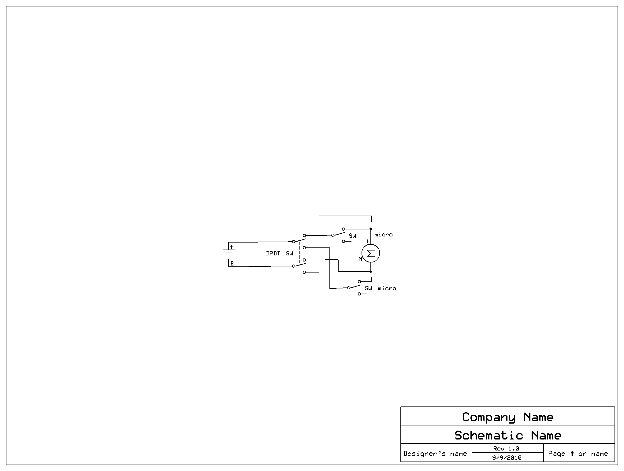

Hi, I'm building a project, the mechanics of which I've got covered. The tricky bit is the electronics side.
It's to control a small motor and gearbox to drive a cam in 180 degree steps in either direction... It's reciprocating like the old carousel slide projectors. Yes I could us stepper motors, but I want it to be simple DC operation.
I've been toying with the use of a micro switch to control its end stops, which don't have to be 100% accurate because there is some play at each 180 degree stop.
I was thinking a 12v supply could be charging a capacitor. When a pulse signal is sent, this capacitor would discharge through the motor... but then all my brains started to melt.
Any thoughts on this would be brilliant.

If a microswitch is something you understand, then use that. You could also use an opto-interruptor or two and maybe some digital logic (a flip-flop, perhaps). Overkill would be a simple optical encoder wheel and a microcontroller...
Motor
You didn't say how you were going to make it go. Here is one with a double pole switch that should work.

The micro switch made sense until the motor came to its first rest position and switched power to the motor off. If the power is now off, how do I now power the motor to the next position. I'm sure there's almost a mechanical solution to this, but my head's starting to hurt.

Does it not go in one direction, stop, and then go the other direction?
Oh I see back and forth.
To make it a little clearer, the cam flips the positions on a model rail turnout, or points. The cam is moved through the 180 degree movement of the motor. The motor can move in just one direction to flip between the two positions, or reverse it doesnt really matter. whichever is simplest is best.

Maybe I still don't understand. In the circuit above you put the switch in one position and the motor turns until the micro switch stops it. To put it back to the original stop you put the switch in the oposite position and it reverses to the other micro switchand stops.
Hi Ronv
There's only one circuit on this post, and you posted it.
