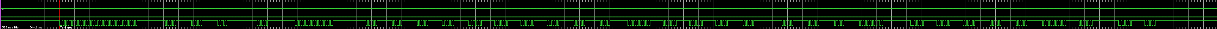

the issue is i thinks its irDA. My remote can also controll my xbox 360. So not sure what it is lol i tried the LA tool for the pickit with no luck meaning i get different results for the same button
I think its a RC6 or NEC. Here is a PNG of data i got.

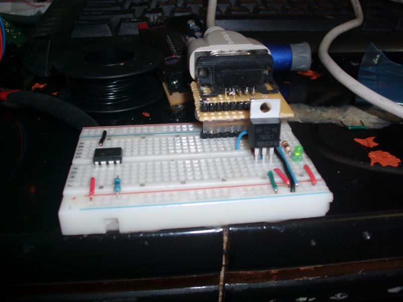

awesome i have all the parts! ill plan to make it with a max232 or max232 and run off of 5v plug tho. ill build in a little but later and take photos and results later thanks!
EDIT:
Do you think i can just use a 7805 and power from RTS on serial?
I based the about edit on:

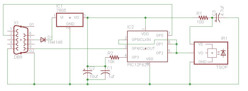

give me like 3 minutes to draw a schematic of what im planning to do itll be fun lol
EDIT:
Bill you are correct but as i dont have any Zener diodes available i cannot use it. i have to make a work around :D
Hey i gota step out for a while. Friend is back from hospital ill finish this later on . But here is a sample.
Test of power. There is a diode there but its behind the 7805 so you might not see it:
test01-jpg.28780

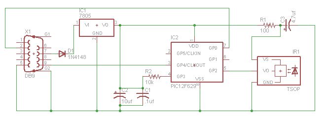

The only thing i can thing of is ... How can this pic drive RS232 levels using 5v+ only? I thought it would have needed 12v+ and 12v- to work?
should i add a max232 to the equation? i have a nice board ready for it.
RS232 works quite happily from 0-5V, all you need for an RS232 interface to a PIC is a single resistor, and that's only for the receive side. You can't use the hardware UART though, only a software one - as a MAX232 inverts the signal.
oh cool. But for some reason this still doesnt seem to be working. So i will try my best to create a program to capture about 200mS - 500ms of data and sent to PC.
