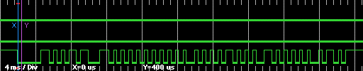

Got it this is my RC6 Power Button
rc6off-png.29096
yeah lol i did a test of most of my remote buttons... attached is png's of a few. I have one png saved as 4x zoom so i can see the timing better.
  • remote.zip
ok its harder than i thought. I cant figure where the Leader ends and data begins and that trailer bit omg lol such a head ache. I rather get the logic tool lol
